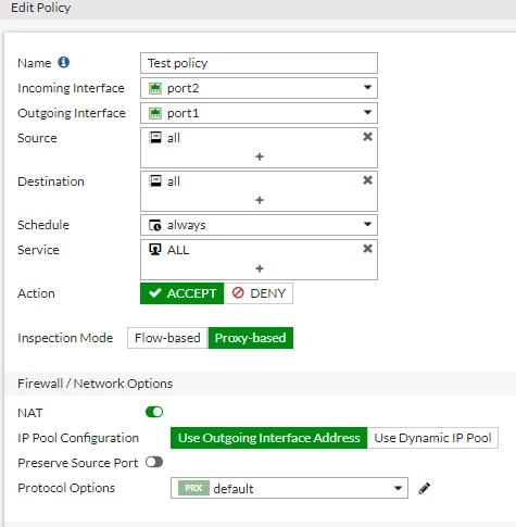

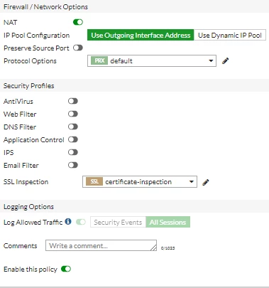

This article describes the changes made to the Inspection Mode in version 6.2. In earlier firmware versions, the Inspection Mode was configured globally to all the policies to either Proxy-based or Flow-based.
In version 6.2 the Inspection Mode has been moved per policy and cannot be set globally enabling more flexible setup for different policies.
When a policy is configured, it is possible to select either Flow-based or proxy-based Inspection mode.
Default is Flow-based Inspection.
To view inspection mode changes in the CLI:
# config firewall policy
        set inspection-mode
        proxy    <--- Proxy based inspection.
        flow     <--- Flow based inspection.
        set inspection-mode proxy
        set name "Test policy"
        set uuid 79d80fb4-bfe9-51e9-38a2-86aefe9dea5e
        set srcintf "port2"
        set dstintf "port1"
        set srcaddr "all"
        set dstaddr "all"
        set schedule-timeout disable
        set service "ALL"
        set nat enable
