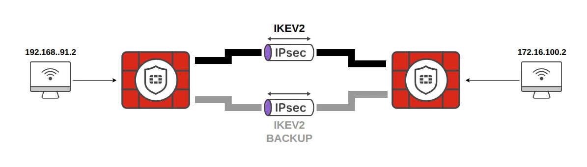

Simple topology:
Scenario:
  1. It is necessary to create a IPsec backup tunnel for redundancy purposes: only one tunnel will be active at one time.
  2. There are 2 ISPs/uplinks setup to reach the IPsec partner .
Refer to this article to create IPsec site-to-site:
Technical Tip: How to configure VPN Site to Site between FortiGates (Using VPN Setup Wizard).
ike2: The primary tunnel.
ike2_backup1: The backup tunnel.
port3: Interface to user network.
Both IPsec tunnels will be up at the same time.
In order to avoid asymmetric routing:
It is necessary to make sure that both sides will have to agree on which tunnel is primary and which tunnel is backup. Make sure that every time FGT1 sends traffic via the primary tunnel to FGT2, FGT2 will reply to the traffic via the primary tunnel too, and vice versa.
Create a simple static route where a higher distance on the backup tunnel has been put so that the backup tunnel will become an active route whenever the primary tunnel is down.
A similar static route is also applied on FGT2:

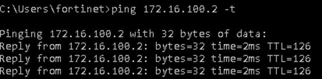

  1. The primary tunnel is being used.
FGT1 # get router info routing-table details 172.16.100.2
Routing table for VRF=0
Routing entry for 0.0.0.0/0
Known via "static", distance 10, metric 0, best
* 192.168.100.2, via ike2distance 0    <----- Ike2 is being used.
Known via "static", distance 254, metric 0
directly connected, Null distance 0
Known via "static", distance 15, metric 0
directly connected, ike2_backup1 distance 0
FGT1 # diagnose sniffer packet any "host 172.16.100.2 and icmp" 4
Using Original Sniffing Mode
interfaces=[any]
filters=[host 172.16.100.2 and icmp]
16.798599 port3 in 192.168.91.2 -> 172.16.100.2: icmp: echo request
16.798622 ike2 out 192.168.91.2 -> 172.16.100.2: icmp: echo request
16.799600 ike2 in 172.16.100.2 -> 192.168.91.2: icmp: echo reply
16.799623 port3 out 172.16.100.2 -> 192.168.91.2: icmp: echo reply

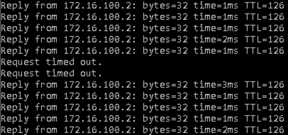

  1. Primary tunnel is down, therefore the backup tunnel is now being used.
192.168.100.2, via ike2 inactive distance 0  <----- primary tunnel is down.
Known via "static", distance 15, metric 0, best
* directly connected, ike2_backup1 distance 0    <----- ike2_backup1 is now being used.
interfaces=[any]
1.577358 port3 in 192.168.91.2 -> 172.16.100.2: icmp: echo request
1.577380 ike2_backup1 out 192.168.91.2 -> 172.16.100.2: icmp: echo request
1.578165 ike2_backup1 in 172.16.100.2 -> 192.168.91.2: icmp: echo reply
1.578185 port3 out 172.16.100.2 -> 192.168.91.2: icmp: echo reply

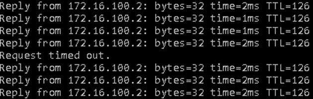

  1. The primary tunnel is now recovered.
interfaces=[any]
