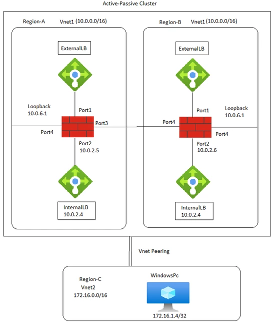

The following example represents the access to the Loopback Interface Across Different VNETs (Scenario 2):
Connecting two or more Virtual Networks in Azure is achieved by virtual network peering.
If the Virtual Networks are located on different Azure regions, global virtual network peering should be used.
Refer to the Virtual network peering Azure documentation for more details:
https://learn.microsoft.com/en-us/azure/virtual-network/virtual-network-peering-overview

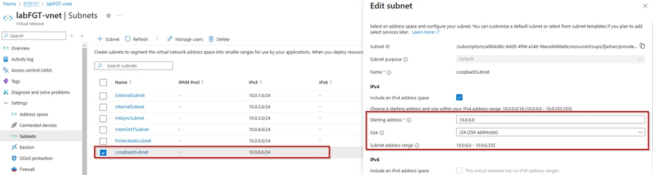

Step 2: Create the same subnet to the FortiGate VNET in Azure.
 Leave all other settings as default.

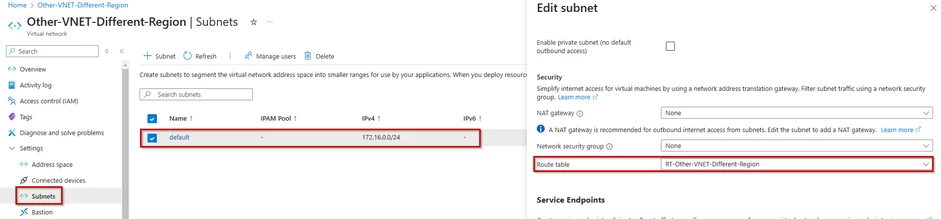

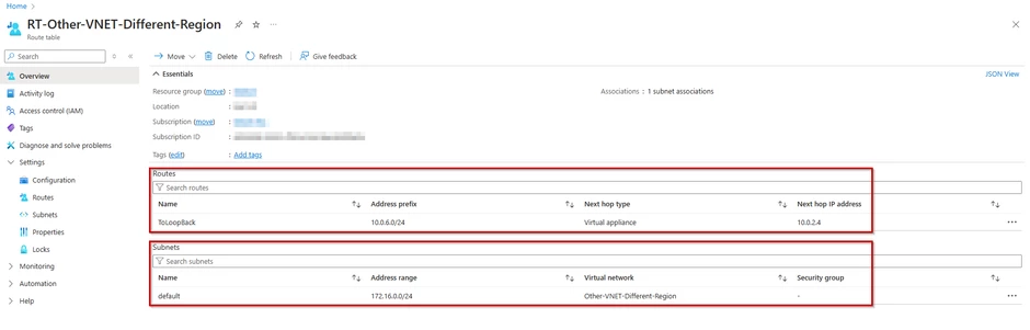

Step 3: Create a Route Table and associate it with the other VNET where Host-VM (WindowsPC) is located.
From the left menu pane, navigate to 'Routes' and fill in all the required information as follows:
  • Route name: ToLoopback.
  • Destination type: IP Addresses.
  • Destination IP addresses/CIDR ranges: 10.0.6.0/24 (Subnet of the Loopback).
  • Next hop type: Virtual Appliance.
  • Next hop address: 10.0.2.4 (IP Address of the Internal Load-Balancer).
Step 4: Associate the created route table to the subnet where the Host-VM is located.

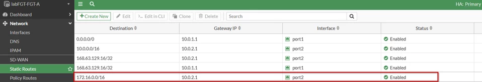

Step 5: To prevent asymmetric routing, create a static route for the Host-VM subnet, pointing towards 'port2' of the FortiGate.
config router static
    edit 5
        set dst 172.16.0.0 255.255.255.0
        set gateway 10.0.2.1
        set device "port2"
