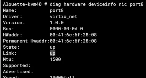

  1. Identify the heartbeat port and confirm if it is up.
show system ha
diagnose hardware deviceinfo nic xxx  <----- Where xxx is the port name.

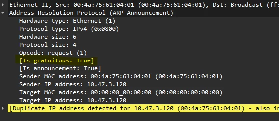

Note: In the Event of Heartbeat packet loss, it will result in a split-brain state where both FortiGates send their GARP packet to the connecting network devices (Router, switch, etc).
diagnose sniffer packet port1 ' ' 6 0 a
This example uses port1 to showcase the behavior:
As seen on the packet capture, it exhibits the IP is 10.47.3.120, which is the IP address assigned to Port1, and by right, the HA primary FortiGate should have a virtual MAC address mapped to it, but since it is in a split-brain condition, it is observed to show there is detection of duplication of this IP.
Note: This capture can be taken on either of the FortiGates.
