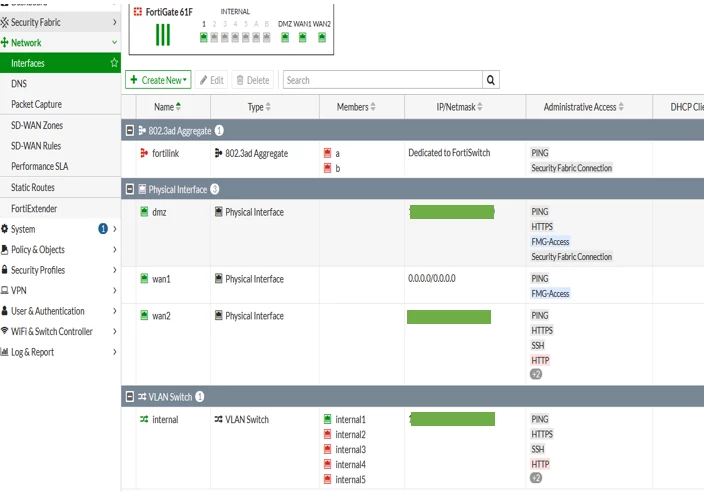

Creating a new interface with 'Type: Hardware-switch' is not possible as the 'Hardware-switch' option is missing.

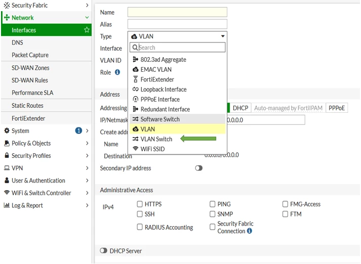

This is because by default globally 'virtual-vlan-switch' is enabled.
In this case only the 'vlan-switch' option will be given.

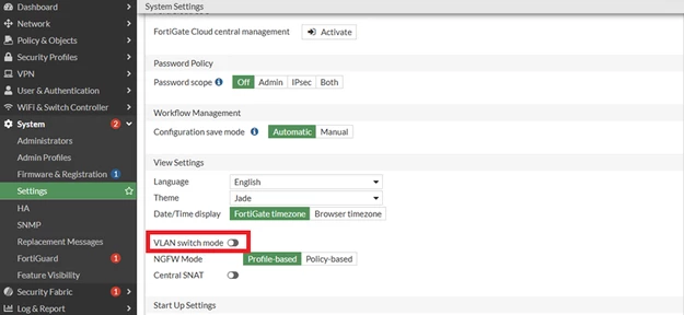

To disable virtual-switch-vlan from the GUI, go to System -> Settings and disable VLAN switch mode:

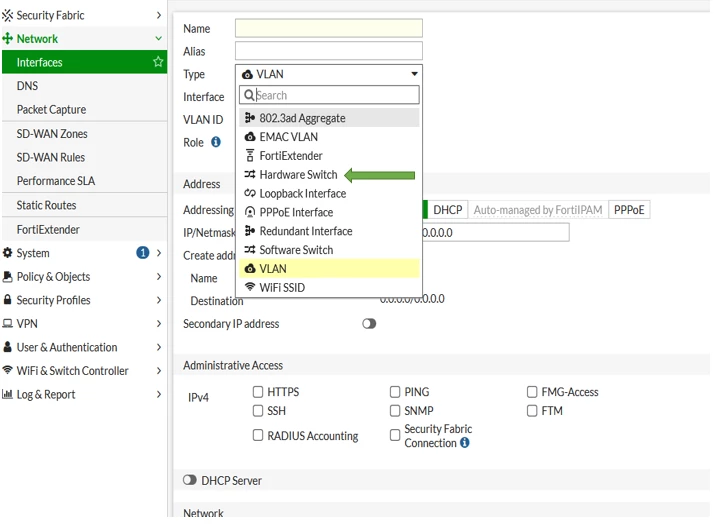

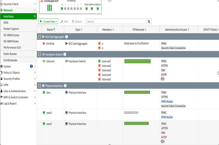

Now when tried to create a new interface, 'Type: Hardware-switch' option shows up as expected.
Note: At any given point of time, either hardware-switch or vlan-switch can be chosen.
