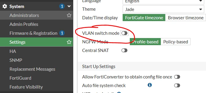

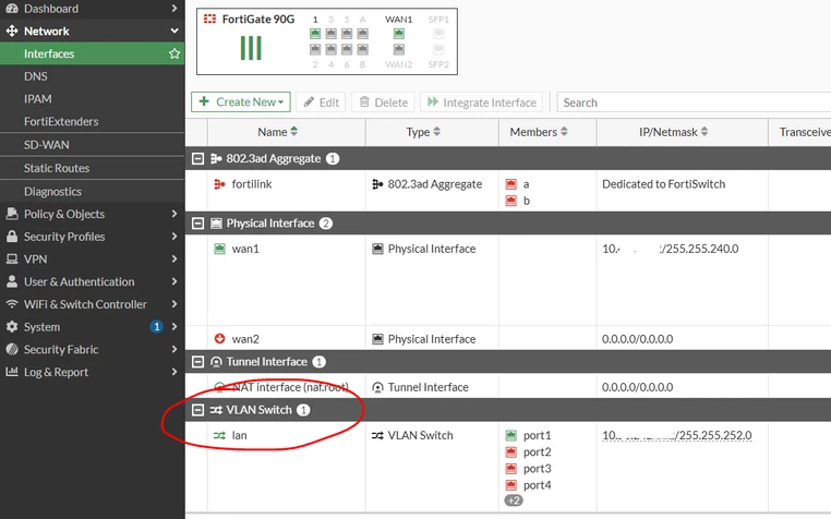

However, this option may not be visible in the FortiGate's interfaces, and instead, a 'VLAN Switch' is shown:
To resolve this issue, it is necessary to disable 'VLAN switch mode' under System -> Settings -> System Operating Settings.
To disable the VLAN switch in the CLI, run the following commands:
config system global
    set virtual-switch-vlan disable

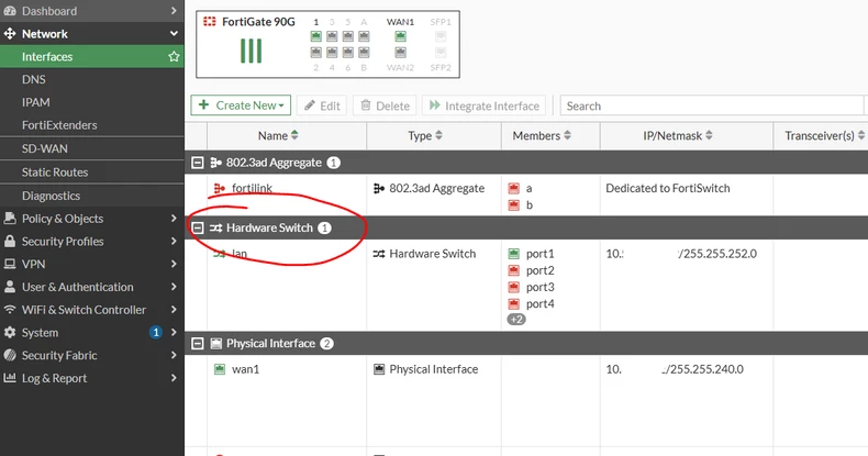

Once this option is changed, it will be possible to see the 'Hardware Switch' via Network -> Interfaces:
