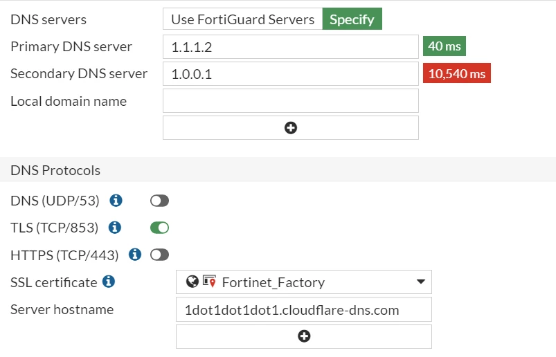

This article describes how to configure FortiGate DNS over TLS using Cloudflare DNS.
Cloudflare DNS:
Primary DNS 1.1.1.2
Secondary DNS 1.0.0.1
From GUI:
From CLI:
# config system dns
    set primary 1.1.1.2
    set secondary 1.0.0.1
    set protocol dot
    set server-hostname "1dot1dot1dot1.cloudflare-dns.com"
Note.
Using incorrect server hostname will result to DNS failure.
Solution When configuring from GUI, do not forget to change the default server hostname 'globalsdns.fortinet.net'.
When using Cloudflare DNS, use 'one.one.one.one' or '1dot1dot1dot1.cloudflare-dns.com' as the server hostname.
