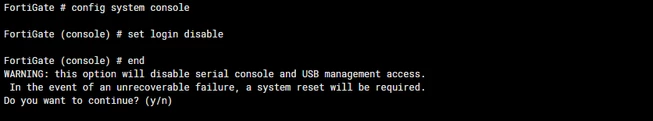

A warning message to confirm the change will be displayed:
Disabling the physical console access does not affect the HTTPS/SSH administrative access via the network interfaces if enabled.
