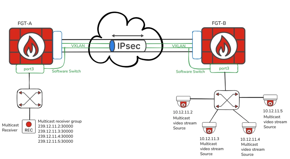

Example Topology:
VXLAN-over-IPSec is configured, and the VXLAN interface is a software switch member. Behind FGT-B, several CCTV cameras are streaming multicast video, which is intended to be received by a recorder located behind FGT-A. Neither of the FortiGates in this setup are performing multicast routing- they are intended to forward multicast frames.
Refer to the following KB article for the VXLAN-over-IPSec configuration: Technical Tip: How to setup a VXLAN over IPsec deployment
