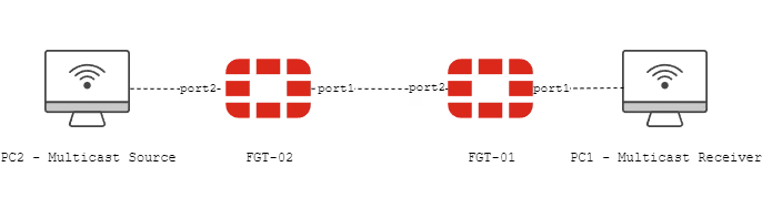

Multicast routing:
Multicast routing involves multicast routing protocols such as PIM sparse-mode and PIM dense-mode. This feature allows more control over multicast traffic, which is useful in more complex setups. Enabling multicast routing will automatically disable multicast forwarding even if it was enabled in the settings.
Multicast routing policies differ from multicast forwarding policies in policy direction and source address, as seen in the example below. To verify the multicast forwarding status, the command diagnose sys vd list can be used. The example configuration below is for PIM dense-mode. The multicast policy configuration is the same for PIM sparse-mode.
Multicast routing policy configuration (FGT-01):
config system settings
    set multicast-forward disable
config router multicast
    set multicast-routing enable
        config interface
            edit "port1"
                set pim-mode dense-mode
                set passive enable
            edit "port2"
config firewall multicast-policy
        set name "multicast_routing"
        set srcintf "port2" <-- Source facing interface
        set dstintf "port1" <-- Receiver facing interface
        set srcaddr "PC2"
        set dstaddr "multicast_group"
Multicast routing policy configuration (FGT-02):
        config interface
            edit "port1"
            edit "port2"
                set passive enable
        set srcaddr "PC2"
