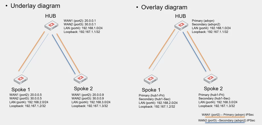

The following topology will be used for this article:

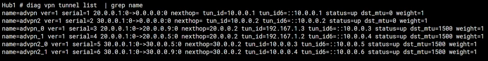

Though both tunnels are configured to exchange loopback IP, only 1 tunnel will get the loopback IP as the tunnel_id. The second tunnel will get an IP from the 10.0.0.0/8 subnet. This can be checked on the Hub
The secondary IP addresses 30.0.0.5 and 30.0.0.9 have a tunnel ID in 10.0.0.x range.
