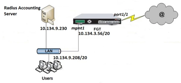

This article explains how to manage the duration of RSSO authentication and sessions.
The example is based on FortiOS v5.4.2 and shows the configuration and the troubleshooting step by step of the parameters 'rsso-context-timeout' and 'rsso-flush-ip-session'.
RSSO, FortiOS v5.2, FortiOS v5.4
RSSO parameters:
rsso-context-timeout: Timeout value for RADIUS server database entries (0 = infinite).
rsso-flush-ip-session: Enable/disable flush user IP sessions on RADIUS accounting stop.
The Radius Accounting server sends Accounting packets to the FortiGate to inform if a user authentication starts or stops (and eventually sends update information).
Accordingly, the FortiGate allows or denies user traffic.
Configuration
 config system interface
    edit "mgmt1"
        set vdom "root"
        set ip 10.134.3.56 255.255.240.0
        set allowaccess ping https ssh http telnet radius-acct
        set type physical
        set role lan
        set snmp-index 12
    edit "port1/1"
        set vdom "root"
        set ip 10.5.19.56 255.255.240.0
        set allowaccess ping https ssh snmp http telnet
        set type physical
        set snmp-index 1
 config router static
        set gateway 10.5.31.254
        set device "port1/1"
 config user radius
    edit "RadiusRsso"
        set rsso enable
        set rsso-secret ENC F7bLsgPVrWICS5RHAo+TGsVTiPMGvhPlZRGmfghV7mU+xHhM0hoTljQQWWwvD10NXrcv84owjyenbS4PxOZxqHnKLP+6xDRHmgKdiIJz3n5hgm2EUET
2XokE3bftmqBc/mRYFJgEUrTm8JUxw/asoDT6O1bP9AiRYtIdAV+c1Lo7OfZ2jIE19WpA/UadeN2qYxazXw==
        set rsso-context-timeout 120 (2 min for test purpose – default values is 28800 sec or 8 hours in 5.4.2)

Verification
Testing rsso-context-timeout parameter
1)  rsso-context-timeout will expire in 2 min as per current setup (but the FortiGate default config is 8 hours).
Activate debug.
        set rsso-flush-ip-session enable
FG-5KD3915xxxxxx (RadiusRsso) # set rsso-context-timeout 0
FG-5KD3915xxxxxx (RadiusRsso) # end
FG-5KD3915xxxxxx #
FG-5KD3915xxxxxx # ui config version changed
config change start
0: update vd root
server config 0 del
filled server 'RadiusRsso' for vdom 'root'
server config 0 add OK
if=mgmt1 interface is up to date (listen enabled)
Update config; timeout time 120 -> 0
db 0x142c0f90 removed timeout alarm
config change done
FG-5KD3915xxxxxx # diagnose  debug  application radiusd -1
FG-5KD3915xxxxxx #  diag de en
FG-5KD3915xxxxxx # Received radius accounting eventvd 0:root Add/Update auth logon for IP 10.134.9.208 for user 33471995584
DB 0 insert [ep='33471995584' pg='Group0' ip='10.134.9.208'] success
FG-5KD3915xxxxxx # diagnose test application radiusd 33
RADIUS server database [vd root]:
"index","start time","time left","ip","endpoint","block status","log status","profile group","ref count","use default profile"
1,1481270573,00:00:00,"10.134.9.208","33471995584","allow","no log","Group0",1,No
FG-5KD3915xxxxxx # Received radius accounting eventDB 0 update [ep='33471995584' pg='Group0' ip='10.134.9.208'] success
1,1481270611,00:00:00,"10.134.9.208","33471995584","allow","no log","Group0",1,No
FG-5KD3915xxxxxx # Received radius accounting eventvd 0:root Remove auth logon for IP 10.134.9.208 for user 33471995584
DB 0 remove by IP [ep='33471995584' pg='Group0' ip='10.134.9.208'] success
 ** no entries **
