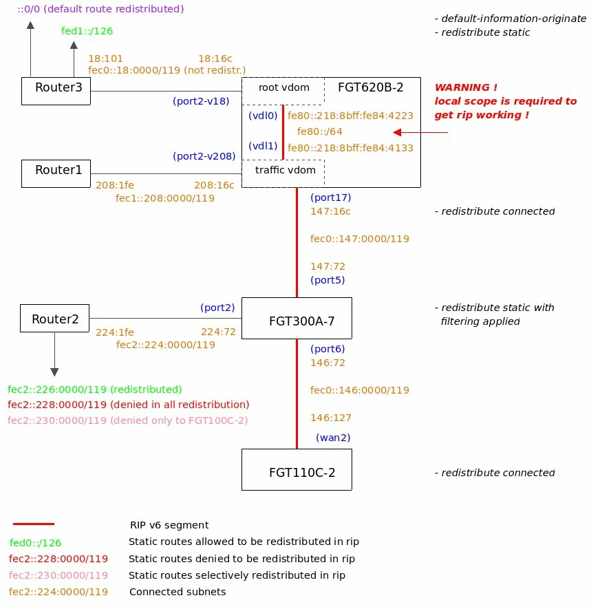

This technical note explains with an example how RIPnG should be configured on a FortiGate unit.
The architecture chosen includes RIPnG over inter-vdom links as well as redistribution filtering either with distribute list or route-map.
Useful commands to verify and troubleshoot RIPnG using FortiGates is covered in this article.
  • Nat/route mode
Diagram
Expectations, Requirements
Expectations:
Based on  the diagram above, the following rules are defined :
  • FGT620B-2 :
    • runs RIPnG on 2 vdoms "root" and "traffic":
      • vdom 'root' :
        • redistributes static route [fed1::/126]
        • injects the default route
        • runs RIPnG on inter-vdom link interface (vdl0) towards vdom 'traffic'
      • vdom 'traffic' :
        • redistributes connected subnets
        • runs RIPng on inter-vdom link interface (vdl1) towards vdom 'root'
  • FGT300A-7:
    • redistributes static routes with filtering applied:
      • general filtering via a route-map to deny static route fec2::228:0000/119 globally from being redistributed
      • specific filtering on (port6) to deny static route fec2::230:0000/119 from being redistributed to FGT110C-2
    • runs RIPnG on interfaces (port5) and (port6)
  • FGT110C-2:
    • redistributes connected routes
Requirement:
Firmware version should be 4.0 MR1 or higher.
Configuration

#1 : Inject the ipv6 default route to RIPnG
Important information regarding inter-vdom link ipv6 addresses :
As RIPnG is using the next-hop interface local scope ipv6 address for routing, each interface used as next-hop must have a local scope ipv6 address configured. This is automatically the case for physical ports or vlan interfaces for which a MAC address is always existing (local scope ipv6 address is derivated from the underlaying port MAC address). However, because a vdom-link does not have such MAC address as it is a point-to-point type of connection, it is mandatory to configured an ipv6 address which is part of the local scope on vdom-link interfaces.
This is the reason why in this setup, (vdl0) and (vdl1) are configured respectively with fe80::218:8bff:fe84:4223/64 and fe80::218:8bff:fe84:4133/64.
If the inter vdom-link interfaces are not configured with local scope ipv6 address, RIPnG would not work.

Notes:
#1 : using 'any' as prefix is a valid keyword which is equivalent to :
set prefix6 "::0/0"
set ge 128
meaning all the prefixes including the default route.
#2 : In this case, the distribute-list configured is specific to (port6), this second filtering level comes after the initial global filtering performed in  #3.
#3 : A general filtering level applied to static routes (applied to all RIPnG interfaces)

Verification
The following commands are used for verification :
  • ipv6 address list : Useful to get the local scope IPv6 addresses used as next-hop by RIPnG
  • diagnose ipv6 route list :   Ipv6 routes installed in the kernel
  • get router info6 rip database : View of the RIPng database (prefix, next-hop, interface, time)
  • get router info6 routing-table : ipv6 routing table
  • get router info6 rip interface <Interface_name> : Details on the RIPnG interface configuration
  • diagnose ipv6 neighbor-cache list : Get the IPv6/MAC address mapping
Output from this commands from the FortiGates in this setup :

C   fe80::/64 via ::, vdl0, 00:27:29
C   fec0::18:0/119 via ::, port2-v18, 00:27:29
R   fec0::146:0/119 [120/3] via fe80::218:8bff:fe84:4133, vdl0, 00:27:22
R   fec0::147:0/119 [120/2] via fe80::218:8bff:fe84:4133, vdl0, 00:27:22
R   fec1::208:0/119 [120/2] via fe80::218:8bff:fe84:4133, vdl0, 00:27:22
R   fec2::224:0/119 [120/3] via fe80::218:8bff:fe84:4133, vdl0, 00:27:22
R   fec2::226:0/119 [120/3] via fe80::218:8bff:fe84:4133, vdl0, 00:27:22
R   fec2::230:0/119 [120/3] via fe80::218:8bff:fe84:4133, vdl0, 00:27:22
S   fed1::/126 [1/0] via fec0::18:101, port2-v18, 00:27:24
FGT620B-2 (root) # get router info6 rip interface vdl0
vdl0 is up, line protocol is up
  Routing Protocol: RIPng
    Passive interface: Disabled
    Split horizon: Enabled with Poisoned Reversed
    IPv6 interface address:
FGT620B-2 (root) # diagnose ipv6 neighbor-cache list
ifindex=2 ifname=port17 ff02::9 33:33:00:00:00:09 state=00000040 use=1562 confirm=178162 update=172162 ref=1
ifindex=23 ifname=root :: 00:00:00:00:00:00 state=00000040 use=173774 confirm=179774 update=173774 ref=4
ifindex=25 ifname=traffic :: 00:00:00:00:00:00 state=00000040 use=173773 confirm=179773 update=173773 ref=6
ifindex=31 ifname=vsys_ha :: 00:00:00:00:00:00 state=00000040 use=173482 confirm=179482 update=173482 ref=1
ifindex=33 ifname=vsys_fgfm :: 00:00:00:00:00:00 state=00000040 use=173174 confirm=179174 update=173174 ref=1
ifindex=27 ifname=vdl0 ff02::9  state=00000040 use=16562 confirm=22562 update=16562 ref=1
ifindex=28 ifname=vdl1 ff02::9  state=00000040 use=16562 confirm=22562 update=16562 ref=1
ifindex=30 ifname=port2-v18 fec0::18:101 state=00000000 use=172265 confirm=178265 update=172265 ref=2
ifindex=2 ifname=port17 fe80::209:fff:fe85:b7a9 00:09:0f:09:0e:04 state=00000004 use=172162 confirm=178162 update=172162 ref=4
ifindex=27 ifname=vdl0 fe80::218:8bff:fe84:4133  state=00000040 use=172162 confirm=178162 update=172162 ref=6
ifindex=28 ifname=vdl1 fe80::218:8bff:fe84:4223  state=00000040 use=172162 confirm=178162 update=172162 ref=2
FGT620B-2 [traffic]
FGT620B-2 (traffic) # diagnose ipv6 address list
dev=33 devname=vsys_fgfm flag=P scope=254 prefix=128 addr=::1
dev=31 devname=vsys_ha flag=P scope=254 prefix=128 addr=::1
dev=29 devname=port2-v208 flag=P scope=200 prefix=119 addr=fec1::208:16c
dev=25 devname=traffic flag=P scope=254 prefix=128 addr=::1
dev=23 devname=root flag=P scope=254 prefix=128 addr=::1
dev=30 devname=port2-v18 flag=P scope=200 prefix=119 addr=fec0::18:16c
dev=2 devname=port17 flag=P scope=253 prefix=10 addr=fe80::209:fff:feb7:3c88
dev=28 devname=vdl1 flag=P scope=253 prefix=64 addr=fe80::218:8bff:fe84:4133
dev=2 devname=port17 flag=P scope=200 prefix=119 addr=fec0::147:16c
dev=27 devname=vdl0 flag=P scope=253 prefix=64 addr=fe80::218:8bff:fe84:4223
dev=30 devname=port2-v18 flag=P scope=253 prefix=10 addr=fe80::209:fff:feb7:3c79
dev=29 devname=port2-v208 flag=P scope=253 prefix=10 addr=fe80::209:fff:feb7:3c79
FGT620B-2 (traffic) # diagnose ipv6 route list
vf=1 type=02 protocol=unspec flag=00200001 oif=25(traffic) dst:::1/128 gwy::: prio=0
vf=1 type=02 protocol=unspec flag=00200001 oif=25(traffic) dst:fe80::209:fff:feb7:3c79/128 gwy::: prio=0
vf=1 type=02 protocol=unspec flag=00200001 oif=25(traffic) dst:fe80::209:fff:feb7:3c88/128 gwy::: prio=0
vf=1 type=02 protocol=unspec flag=00200001 oif=25(traffic) dst:fe80::218:8bff:fe84:4133/128 gwy::: prio=0
vf=1 type=01 protocol=kernel flag=00040001 oif=28(vdl1) dst:fe80::/64 prio=100
vf=1 type=07 protocol=boot flag=00200200 oif=25(traffic) dst:fe80::/10 prio=100
vf=1 type=01 protocol=kernel flag=00040001 oif=29(port2-v208) dst:fe80::/10 prio=100
vf=1 type=01 protocol=kernel flag=00040001 oif=2(port17) dst:fe80::/10 prio=100
vf=1 type=01 protocol=kernel flag=00040001 oif=28(vdl1) dst:fe80::/10 prio=100
vf=1 type=01 protocol=zebra flag=00000003 oif=2(port17) dst:fec0::146:0/119 gwy:fe80::209:fff:fe85:b7a9 prio=400
vf=1 type=02 protocol=unspec flag=00200001 oif=25(traffic) dst:fec0::147:16c/128 gwy::: prio=0
vf=1 type=01 protocol=kernel flag=00040001 oif=2(port17) dst:fec0::147:0/119 prio=100
vf=1 type=02 protocol=unspec flag=00200001 oif=25(traffic) dst:fec1::208:16c/128 gwy::: prio=0
vf=1 type=01 protocol=kernel flag=00040001 oif=29(port2-v208) dst:fec1::208:0/119 prio=100
vf=1 type=01 protocol=zebra flag=00000003 oif=2(port17) dst:fec2::224:0/119 gwy:fe80::209:fff:fe85:b7a9 prio=400
vf=1 type=01 protocol=zebra flag=00000003 oif=2(port17) dst:fec2::226:0/119 gwy:fe80::209:fff:fe85:b7a9 prio=400
vf=1 type=01 protocol=zebra flag=00000003 oif=2(port17) dst:fec2::230:0/119 gwy:fe80::209:fff:fe85:b7a9 prio=400
vf=1 type=01 protocol=zebra flag=00000003 oif=28(vdl1) dst:fed1::/126 gwy:fe80::218:8bff:fe84:4223 prio=400
vf=1 type=01 protocol=kernel flag=01040001 oif=2(port17) dst:ff02::9/128 gwy:ff02::9 prio=0
vf=1 type=01 protocol=kernel flag=01040001 oif=28(vdl1) dst:ff02::9/128 gwy:ff02::9 prio=0
vf=1 type=07 protocol=boot flag=00200200 oif=25(traffic) dst:ff00::/8 prio=100
vf=1 type=01 protocol=kernel flag=00040001 oif=29(port2-v208) dst:ff00::/8 prio=100
vf=1 type=01 protocol=kernel flag=00040001 oif=2(port17) dst:ff00::/8 prio=100
vf=1 type=01 protocol=kernel flag=00040001 oif=28(vdl1) dst:ff00::/8 prio=100
vf=1 type=01 protocol=zebra flag=00000003 oif=28(vdl1) gwy:fe80::218:8bff:fe84:4223 prio=400
FGT620B-2 (traffic) # get router info6 rip database
Codes: R - RIP, Rc - RIP connected, Rs - RIP static, Ra - RIP aggregated,
       Rcx - RIP connect suppressed, Rsx - RIP static suppressed,
       K - Kernel, C - Connected, S - Static, O - OSPF, I - IS-IS, B - BGP
   Network                     Next Hop                  If     Met Tag  Time
R  ::/0                        fe80::218:8bff:fe84:4223  vdl1     2   0 02:30
R  fec0::146:0/119             fe80::209:fff:fe85:b7a9   port17   2   0 02:57
C  fec0::147:0/119             ::                        port17   1   0
C  fec1::208:0/119             ::                        port2-v208   1   0
R  fec2::224:0/119             fe80::209:fff:fe85:b7a9   port17   2   0 02:57
R  fec2::226:0/119             fe80::209:fff:fe85:b7a9   port17   2   0 02:57
R  fec2::230:0/119             fe80::209:fff:fe85:b7a9   port17   2   0 02:57
R  fed1::/126                  fe80::218:8bff:fe84:4223  vdl1     2   0 02:30
FGT620B-2 (traffic) # get router info6 routing-table
IPv6 Routing Table
Codes: K - kernel route, C - connected, S - static, R - RIP, O - OSPF,
       I - IS-IS, B - BGP
Timers: Uptime
R   ::/0 [120/2] via fe80::218:8bff:fe84:4223, vdl1, 00:34:47
C   ::1/128 via ::, traffic, 00:34:53
C   fe80::/10 via ::, port2-v208, 00:34:53
              via ::, port17, 00:34:53
C   fe80::/64 via ::, vdl1, 00:34:53
R   fec0::146:0/119 [120/2] via fe80::209:fff:fe85:b7a9, port17, 00:34:47
C   fec0::147:0/119 via ::, port17, 00:34:53
C   fec1::208:0/119 via ::, port2-v208, 00:34:53
R   fec2::224:0/119 [120/2] via fe80::209:fff:fe85:b7a9, port17, 00:34:47
R   fec2::226:0/119 [120/2] via fe80::209:fff:fe85:b7a9, port17, 00:34:47
R   fec2::230:0/119 [120/2] via fe80::209:fff:fe85:b7a9, port17, 00:34:47
R   fed1::/126 [120/2] via fe80::218:8bff:fe84:4223, vdl1, 00:34:47
FGT620B-2 (traffic) # diagnose ipv6 neighbor-cache list
ifindex=2 ifname=port17 ff02::9 33:33:00:00:00:09 state=00000040 use=1418 confirm=215118 update=209118 ref=1
ifindex=23 ifname=root :: 00:00:00:00:00:00 state=00000040 use=210730 confirm=216730 update=210730 ref=4
ifindex=25 ifname=traffic :: 00:00:00:00:00:00 state=00000040 use=210729 confirm=216729 update=210729 ref=6
ifindex=31 ifname=vsys_ha :: 00:00:00:00:00:00 state=00000040 use=210438 confirm=216438 update=210438 ref=1
ifindex=33 ifname=vsys_fgfm :: 00:00:00:00:00:00 state=00000040 use=210130 confirm=216130 update=210130 ref=1
ifindex=27 ifname=vdl0 ff02::9  state=00000040 use=6023 confirm=12023 update=6023 ref=1
ifindex=28 ifname=vdl1 ff02::9  state=00000040 use=6023 confirm=12023 update=6023 ref=1
ifindex=30 ifname=port2-v18 fec0::18:101 state=00000000 use=209221 confirm=215221 update=209221 ref=2
ifindex=2 ifname=port17 fe80::209:fff:fe85:b7a9 00:09:0f:09:0e:04 state=00000004 use=209118 confirm=215118 update=209118 ref=4
ifindex=27 ifname=vdl0 fe80::218:8bff:fe84:4133  state=00000040 use=209118 confirm=215118 update=209118 ref=6
ifindex=28 ifname=vdl1 fe80::218:8bff:fe84:4223  state=00000040 use=209118 confirm=215118 update=209118 ref=2
FGT620B-2 (traffic) # get router info6 rip interface vdl1
vdl1 is up, line protocol is up
FGT620B-2 (traffic) # get router info6 rip interface port17
port17 is up, line protocol is up
      fe80::209:fff:feb7:3c88/10
      fec0::147:16c/119
FGT310A-7
FGT300A-7 # diagnose ipv6 address list
dev=6 devname=port6 flag=P scope=253 prefix=10 addr=fe80::209:fff:fe85:b7aa
dev=13 devname=vsys_fgfm flag=P scope=254 prefix=128 addr=::1
dev=11 devname=vsys_ha flag=P scope=254 prefix=128 addr=::1
dev=3 devname=port2 flag=P scope=200 prefix=119 addr=fec2::224:72
dev=9 devname=root flag=P scope=254 prefix=128 addr=::1
dev=7 devname=port5 flag=P scope=253 prefix=10 addr=fe80::209:fff:fe85:b7a9
dev=6 devname=port6 flag=P scope=200 prefix=119 addr=fec0::146:72
dev=7 devname=port5 flag=P scope=200 prefix=119 addr=fec0::147:72
dev=3 devname=port2 flag=P scope=253 prefix=10 addr=fe80::209:fff:fe85:b7a6
FGT300A-7 # diagnose ipv6 route list
vf=0 type=02 protocol=unspec flag=00200001 oif=9(root) dst:::1/128 gwy::: prio=0
vf=0 type=02 protocol=unspec flag=00200001 oif=9(root) dst:fe80::209:fff:fe85:b7a6/128 gwy::: prio=0
vf=0 type=02 protocol=unspec flag=00200001 oif=9(root) dst:fe80::209:fff:fe85:b7a9/128 gwy::: prio=0
vf=0 type=02 protocol=unspec flag=00200001 oif=9(root) dst:fe80::209:fff:fe85:b7aa/128 gwy::: prio=0
vf=0 type=07 protocol=boot flag=00200200 oif=9(root) dst:fe80::/10 prio=100
vf=0 type=01 protocol=kernel flag=00040001 oif=3(port2) dst:fe80::/10 prio=100
vf=0 type=01 protocol=kernel flag=00040001 oif=7(port5) dst:fe80::/10 prio=100
vf=0 type=01 protocol=kernel flag=00040001 oif=6(port6) dst:fe80::/10 prio=100
vf=0 type=01 protocol=kernel flag=00040001 oif=15(havdlink1) dst:fe80::/10 prio=100
vf=0 type=02 protocol=unspec flag=00200001 oif=9(root) dst:fec0::146:72/128 gwy::: prio=0
vf=0 type=01 protocol=kernel flag=00040001 oif=6(port6) dst:fec0::146:0/119 prio=100
vf=0 type=02 protocol=unspec flag=00200001 oif=9(root) dst:fec0::147:72/128 gwy::: prio=0
vf=0 type=01 protocol=kernel flag=00040001 oif=7(port5) dst:fec0::147:0/119 prio=100
vf=0 type=01 protocol=zebra flag=00000003 oif=7(port5) dst:fec1::208:0/119 gwy:fe80::209:fff:feb7:3c88 prio=400
vf=0 type=02 protocol=unspec flag=00200001 oif=9(root) dst:fec2::224:72/128 gwy::: prio=0
vf=0 type=01 protocol=kernel flag=00040001 oif=3(port2) dst:fec2::224:0/119 prio=100
vf=0 type=01 protocol=zebra flag=00000003 oif=3(port2) dst:fec2::226:0/119 gwy:fec2::224:1fe prio=1
vf=0 type=01 protocol=zebra flag=00000003 oif=3(port2) dst:fec2::228:0/119 gwy:fec2::224:1fe prio=1
vf=0 type=01 protocol=zebra flag=00000003 oif=3(port2) dst:fec2::230:0/119 gwy:fec2::224:1fe prio=1
vf=0 type=01 protocol=zebra flag=00000003 oif=7(port5) dst:fed1::/126 gwy:fe80::209:fff:feb7:3c88 prio=400
vf=0 type=07 protocol=boot flag=00200200 oif=9(root) dst:ff00::/8 prio=100
vf=0 type=01 protocol=kernel flag=00040001 oif=3(port2) dst:ff00::/8 prio=100
vf=0 type=01 protocol=kernel flag=00040001 oif=7(port5) dst:ff00::/8 prio=100
vf=0 type=01 protocol=kernel flag=00040001 oif=6(port6) dst:ff00::/8 prio=100
vf=0 type=01 protocol=kernel flag=00040001 oif=15(havdlink1) dst:ff00::/8 prio=100
vf=0 type=01 protocol=zebra flag=00000003 oif=7(port5) gwy:fe80::209:fff:feb7:3c88 prio=400
FGT300A-7 # get router info6 rip database
R  ::/0                        fe80::209:fff:feb7:3c88   port5    3   0 02:37
C  fec0::146:0/119             ::                        port6    1   0
C  fec0::147:0/119             ::                        port5    1   0
R  fec1::208:0/119             fe80::209:fff:feb7:3c88   port5    2   0 02:37
C  fec2::224:0/119             ::                        port2    1   0
S  fec2::226:0/119             fec2::224:1fe             port2    1   0
S  fec2::230:0/119             fec2::224:1fe             port2    1   0
R  fed1::/126                  fe80::209:fff:feb7:3c88   port5    3   0 02:37
FGT300A-7 # get router info6 routing-table
IPv6 Routing Table
       I - IS-IS, B - BGP
Timers: Uptime
R   ::/0 [120/3] via fe80::209:fff:feb7:3c88, port5, 00:42:56
C   ::1/128 via ::, root, 01:44:09
C   fe80::/10 via ::, port5, 01:44:09
              via ::, port6, 01:44:09
              via ::, port2, 01:44:09
C   fec0::146:0/119 via ::, port6, 01:44:09
C   fec0::147:0/119 via ::, port5, 01:44:09
R   fec1::208:0/119 [120/2] via fe80::209:fff:feb7:3c88, port5, 00:42:56
C   fec2::224:0/119 via ::, port2, 01:44:09
S   fec2::226:0/119 [1/0] via fec2::224:1fe, port2, 01:43:45
S   fec2::228:0/119 [1/0] via fec2::224:1fe, port2, 01:43:45
S   fec2::230:0/119 [1/0] via fec2::224:1fe, port2, 01:43:45
R   fed1::/126 [120/3] via fe80::209:fff:feb7:3c88, port5, 00:42:56
FGT300A-7 # get router info6 rip interface port5
port5 is up, line protocol is up
      fe80::209:fff:fe85:b7a9/10
      fec0::147:72/119
FGT300A-7 # get router info6 rip interface port6
port6 is up, line protocol is up
      fe80::209:fff:fe85:b7aa/10
      fec0::146:72/119
FGT300A-7 # diagnose ipv6 neighbor-cache list
ifindex=9 ifname=root :: 00:00:00:00:00:00 state=00000040 use=628259 confirm=634259 update=628259 ref=7
ifindex=11 ifname=vsys_ha :: 00:00:00:00:00:00 state=00000040 use=628152 confirm=634152 update=628152 ref=1
ifindex=13 ifname=vsys_fgfm :: 00:00:00:00:00:00 state=00000040 use=628078 confirm=634078 update=628078 ref=1
ifindex=6 ifname=port6 ff02::9 33:33:00:00:00:09 state=00000040 use=707 confirm=631207 update=625207 ref=0
ifindex=7 ifname=port5 ff02::9 33:33:00:00:00:09 state=00000040 use=707 confirm=631207 update=625207 ref=0
ifindex=3 ifname=port2 fec2::224:1fe state=00000000 use=625300 confirm=631300 update=625300 ref=3
ifindex=7 ifname=port5 fe80::209:fff:feb7:3c88 00:09:0f:b7:3c:88 state=00000004 use=260508 confirm=260508 update=257747 ref=3
FGT100C-2
FG100C3G08600068 # diagnose ipv6 address list
dev=11 devname=vsys_fgfm flag=P scope=254 prefix=128 addr=::1
dev=9 devname=vsys_ha flag=P scope=254 prefix=128 addr=::1
dev=5 devname=root flag=P scope=254 prefix=128 addr=::1
dev=7 devname=wan2 flag=P scope=200 prefix=119 addr=fec0::146:127
dev=7 devname=wan2 flag=P scope=253 prefix=10 addr=fe80::209:fff:fea3:2eb
FG100C3G08600068 # diagnose ipv6 route list
vf=0 type=02 protocol=unspec flag=00200001 oif=5(root) dst:::1/128 gwy::: prio=0
vf=0 type=02 protocol=unspec flag=00200001 oif=5(root) dst:fe80::209:fff:fea3:2eb/128 gwy::: prio=0
vf=0 type=07 protocol=boot flag=00200200 oif=5(root) dst:fe80::/10 prio=100
vf=0 type=01 protocol=kernel flag=00040001 oif=7(wan2) dst:fe80::/10 prio=100
vf=0 type=02 protocol=unspec flag=00200001 oif=5(root) dst:fec0::146:127/128 gwy::: prio=0
vf=0 type=01 protocol=kernel flag=00040001 oif=7(wan2) dst:fec0::146:0/119 prio=100
vf=0 type=01 protocol=zebra flag=00000003 oif=7(wan2) dst:fec0::147:0/119 gwy:fe80::209:fff:fe85:b7aa prio=400
vf=0 type=01 protocol=zebra flag=00000003 oif=7(wan2) dst:fec1::208:0/119 gwy:fe80::209:fff:fe85:b7aa prio=400
vf=0 type=01 protocol=zebra flag=00000003 oif=7(wan2) dst:fec2::224:0/119 gwy:fe80::209:fff:fe85:b7aa prio=400
vf=0 type=01 protocol=zebra flag=00000003 oif=7(wan2) dst:fec2::226:0/119 gwy:fe80::209:fff:fe85:b7aa prio=400
vf=0 type=01 protocol=zebra flag=00000003 oif=7(wan2) dst:fed1::/126 gwy:fe80::209:fff:fe85:b7aa prio=400
vf=0 type=07 protocol=boot flag=00200200 oif=5(root) dst:ff00::/8 prio=100
vf=0 type=01 protocol=kernel flag=00040001 oif=7(wan2) dst:ff00::/8 prio=100
vf=0 type=01 protocol=zebra flag=00000003 oif=7(wan2) gwy:fe80::209:fff:fe85:b7aa prio=400
FG100C3G08600068 # get router info6 rip database
R  ::/0                        fe80::209:fff:fe85:b7aa   wan2     4   0 02:51
C  fec0::146:0/119             ::                        wan2     1   0
R  fec0::147:0/119             fe80::209:fff:fe85:b7aa   wan2     2   0 02:51
R  fec1::208:0/119             fe80::209:fff:fe85:b7aa   wan2     3   0 02:51
R  fec2::224:0/119             fe80::209:fff:fe85:b7aa   wan2     2   0 02:51
R  fec2::226:0/119             fe80::209:fff:fe85:b7aa   wan2     2   0 02:51
R  fed1::/126                  fe80::209:fff:fe85:b7aa   wan2     4   0 02:51
FG100C3G08600068 # get router info6 routing-table
IPv6 Routing Table
       I - IS-IS, B - BGP
Timers: Uptime
R   ::/0 [120/4] via fe80::209:fff:fe85:b7aa, wan2, 00:44:26
C   ::1/128 via ::, root, 04:09:24
C   fe80::/10 via ::, wan2, 04:09:24
C   fec0::146:0/119 via ::, wan2, 04:09:24
R   fec0::147:0/119 [120/2] via fe80::209:fff:fe85:b7aa, wan2, 01:44:29
R   fec1::208:0/119 [120/3] via fe80::209:fff:fe85:b7aa, wan2, 00:44:26
R   fec2::224:0/119 [120/2] via fe80::209:fff:fe85:b7aa, wan2, 01:44:29
R   fec2::226:0/119 [120/2] via fe80::209:fff:fe85:b7aa, wan2, 01:44:29
R   fed1::/126 [120/4] via fe80::209:fff:fe85:b7aa, wan2, 00:44:26
FG100C3G08600068 # get router info6 rip interface wan2
wan2 is up, line protocol is up
      fe80::209:fff:fea3:2eb/10
      fec0::146:127/119
FG100C3G08600068 # diagnose ipv6 neighbor-cache list
ifindex=5 ifname=root :: 00:00:00:00:00:00 state=00000040 use=1499395 confirm=1505395 update=1499395 ref=3
ifindex=9 ifname=vsys_ha :: 00:00:00:00:00:00 state=00000040 use=1498770 confirm=1504770 update=1498770 ref=1
ifindex=11 ifname=vsys_fgfm :: 00:00:00:00:00:00 state=00000040 use=1498380 confirm=1504380 update=1498380 ref=1
ifindex=7 ifname=wan2 ff02::9 33:33:00:00:00:09 state=00000040 use=2501 confirm=1503372 update=1497372 ref=1
ifindex=7 ifname=wan2 fe80::209:fff:fe85:b7aa state=00000000 use=628418 confirm=634418 update=628418 ref=6
Troubleshooting
  • Use the sniffer to capture Ipv6 packets
  • Turn on ipv6 debug using diagnose ipv6 router rip commands
Example of output from FGT300A-7 :
FGT300A-7 # diagnose debug enable
FGT300A-7 # diagnose ipv6 router rip level info
FGT300A-7 # diagnose ipv6 router rip all enable
FGT300A-7 # RIPng: RECV[port5]: Receive from [fe80::209:fff:feb7:3c88]:521
RIPng: RECV[port5]: RESPONSE version 1 packet size 164
RIPng:   ::/0 metric 2 tag 0
RIPng:   fec0::146:0/119 metric 16 tag 0
RIPng:   fec0::147:0/119 metric 16 tag 0
RIPng:   fec1::208:0/119 metric 1 tag 0
RIPng:   fec2::224:0/119 metric 16 tag 0
RIPng:   fec2::226:0/119 metric 16 tag 0
RIPng:   fec2::230:0/119 metric 16 tag 0
RIPng:   fed1::/126 metric 2 tag 0
RIPng: RECV[port6]: Receive from [fe80::209:fff:fea3:2eb]:521
RIPng: RECV[port6]: RESPONSE version 1 packet size 144
RIPng:   ::/0 metric 16 tag 0
RIPng:   fec1::208:0/119 metric 16 tag 0
RIPng:   fed1::/126 metric 16 tag 0
RIPng: UPDATE: Update timer expired!
RIPng: UPDATE[port6]: Update RIPng routes to [ff02::9]:521
RIPng: SEND[port6]: fec2::230:0/119 is filtered by prefix-list pl6_selective_static6_distribroot
RIPng: SEND[port6]: Send to [ff02::9]:521
RIPng: SEND[port6]: RESPONSE version 1 packet size 144
RIPng:   ::/0 metric 3 tag 0
RIPng:   fec0::147:0/119 metric 1 tag 0
RIPng:   fec1::208:0/119 metric 2 tag 0
RIPng:   fec2::224:0/119 metric 1 tag 0
RIPng:   fec2::226:0/119 metric 1 tag 0
RIPng:   fed1::/126 metric 3 tag 0
RIPng: UPDATE[port5]: Update RIPng routes to [ff02::9]:521
RIPng: SEND[port5]: Send to [ff02::9]:521
RIPng: SEND[port5]: RESPONSE version 1 packet size 164
RIPng:   fec0::146:0/119 metric 1 tag 0
RIPng:   fec2::230:0/119 metric 1 tag 0
