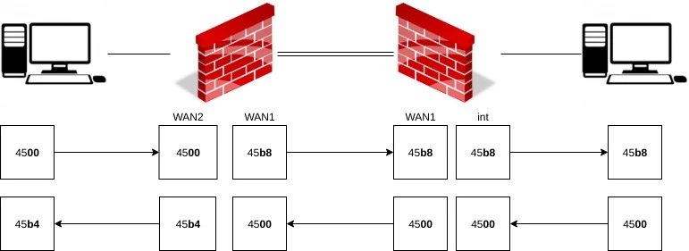

The binary DSCP values in this configuration map to the following hexadecimal TOS field values, which are observable by a sniffer (also known as a packet tracer):
- DSCP 000000 is TOS field 0x00
- DSCP 101101 is TOS field 0xb4
- DSCP 101110 is TOS field 0xb8, the recommended DSCP value for expedited forwarding (EF)
If you performed an ICMP ping between PC A and PC B, the following would illustrate the IP headers observed for the request and the reply by sniffers on each of FortiGate A's and FortiGate B's network interfaces. The rightmost two digits of each IP header are the TOS field, which contains the DSCP value.
