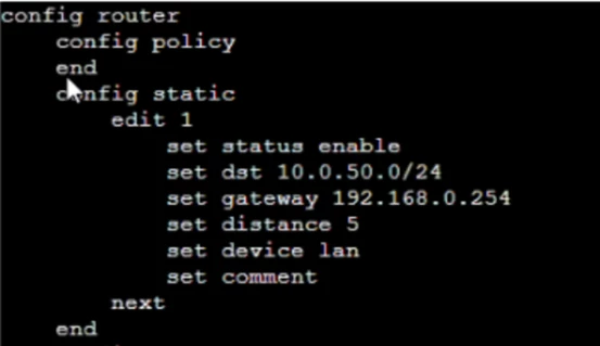

To connect to the FortiExtender from a different VLAN or subnet, it's necessary to create a static route on the FortiExtender.
To do this, connect to the FortiExtender CLI and add a static route on FEX to the PC or Server from which to establish a connection such as ping, ssh, http, https.
#config router static
set status enable
set dst 0.0.0.0/0 (The PC/Server Network ID)
set gateway <fgt-intf-gateway> (IP of the FortiGate interface connected to FortiExtender)
set device <exiting intf> (PORT of the FortiExtender connected to FortiGate)
show
For example:
Note: Ensure that the FortiExtender port allows the necessary connection. For example: http, https, ping, ssh, or telnet.
