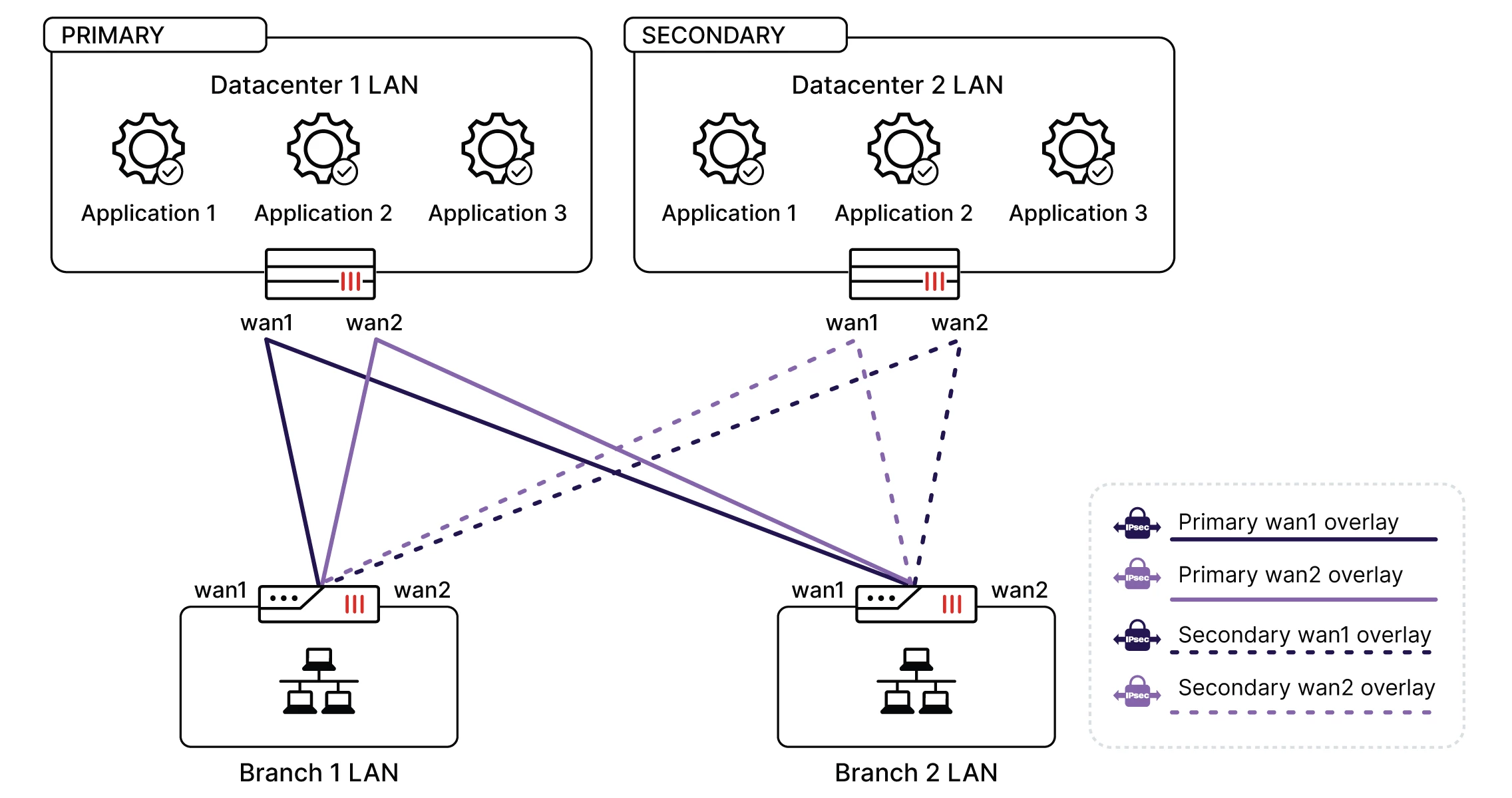

Multiple datacenters (primary/primary gateways)
In this design, branch SD-WAN devices now have two (or more) gateways at separate geo-redundant locations from which to steer traffic. Both hub devices are primary instead of active/passive. This design is common where hub devices provide remote access to different resources.
  •     Example 1: HUB1 in HQ, HUB2 in Datacenter
  •     Example 2: HUB1 in Datacenter, HUB2 in AWS
  •     Example 3: HUB1 in AWS, HUB2 in Azure
4dec9743b60692eb4959c9cec22f437f_image_15
