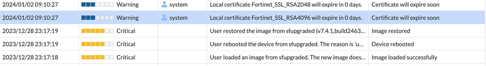

Our system was set for a schedule firmware upgrade - 7.4.1 to 7.4.2.
There was a scheduled automated message about the upgrade "Automatic firmware upgrade schedule changed" which housed when and what:
date=2023-12-22 time=23:08:37 devid="xxxx" devname="FG-companyname-SC" eventtime=1703315317648109599 tz="-0800" logid="xxx" type="event" subtype="system" level="notice" vd="root" logdesc="Automatic firmware upgrade schedule changed" user="system" msg="System patch-level auto-upgrade new image installation scheduled between local time Thu Dec 28 23:16:15 2023 and local time Fri Dec 29 01:00:00 2023."
And in our logs we have a critical event (see screenshot) where this was actioned (in line with the timing listed in the email above) and we've just had reports that the there is no wifi being served through this.
A hard reset of the fortigate seems to resolve this issue but happens everytime the system reboots itself after an update.
What I find interesting is that there is no events between the 28th and 2nd Jan.
Its worth noting that there is also a warning in the logs after this update on 28th December but unsure if connected so will mention it never the less:
Local certificate Fortinet_SSL_RSA4096 will expire in 0 days.
Is there a known issue or something specific I could search for in order to help track down what the potential issue is for this?

Would you think that the invalid certificate would also cause the reboot/relaunch of the device to fail?

Yes we scheduled the firmwarre upgrade. Im assuming based on previous experience around firmware updates for switches/routeres that it needed a reboot. My highlight on the cert error, was merely that of question, rather than indication that this was the cause of the problem.
Could the failed cert stop the fortigate device from coming back online after a firmware upgrade?
The status LED for the device was off when we came to the device and did a hard reset (pull the power out and plug it back in)

As I mentioned, expired certificate shouldn't cause a reboot. I understand that the FortiGate was bot able to boot up and you had to hard reboot it. Can you confirm if the firmware upgrade was successful or not? Please also provide the output of this command "di deb crashlog read".
Regards,
According to the logs, yes, but its worded weirdly.
The status of the device confirms yes though.
