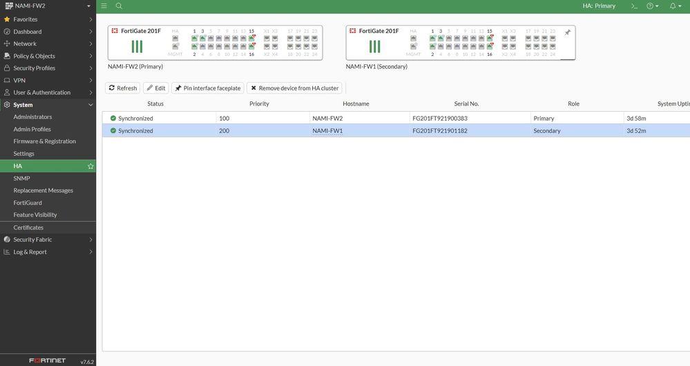

Thank you for your assistance. I have two devices in the HA group, but I am currently able to access the GUI on only one device. Unfortunately, I am unable to access the GUI on the other device after rebooting it.
Hi @Jacky1 ,
1) Were you able to access the Secondary device in GUI before?
2) Please share the HA settings with this command:
show sys ha
1) Yes, I was able to access the secondary and primary device in the GUI before, but now I am unable to do so after the latest firmware update.
2) NAMI-FW2 # show sys ha
config system ha
set group-name "NAMI-FW"
set mode a-p
set password ----
set hbdev "port15" 0 "port16" 0
set ha-mgmt-status enable
config ha-mgmt-interfaces
set interface "mgmt"
set override disable
set priority 100
set monitor "port1" "port2" "port3"
