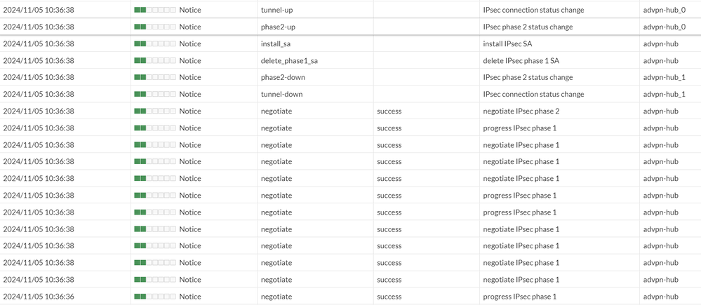

I checked the VPN event logs on the hub, and it looks like whenever one tunnel (like to Spoke-A) connects, the other tunnel (to Spoke-B) disconnects. This keeps happening back and forth, so only one tunnel is active at any time, which is causing around 50% packet loss.
Phase 1 seems fine, but something seems off with Phase 2. I’ve attached a screenshot showing this pattern in the logs. Here’s the current Phase 2 config on all three devices:

Thank you for responding @ctyctyctctcty,
Could you check how the destination is responding configured in the Performance SLA? How SD-WAN is configured and what are the priorities.
The Phase 1 setup seems stable, but Phase 2 is where the problem arises.
This issue requires detailed analysis. I would recommend reaching out to TAC support for in-depth troubleshooting, as this issue requires in depth troubleshooting.
@Umer221
Disabling the add-route option in the VPN configuration resolved the issue.
Thank you for your guidance.
