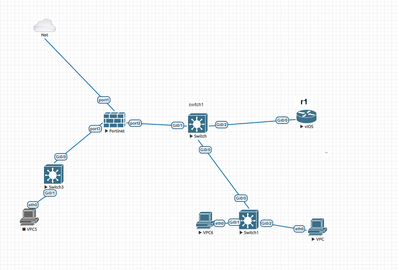

Hi ,
I have the below topology . Here R1 is conigured router on stick . switch 1 is L2

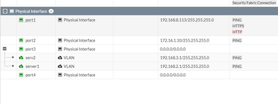

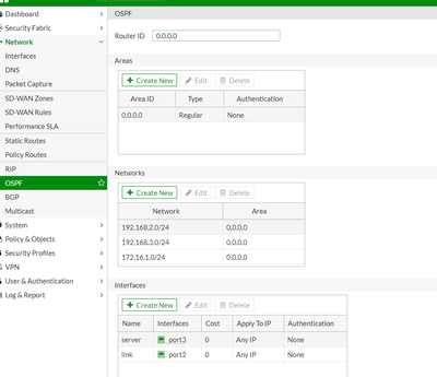

The purpose is r1 want to learn all the network from fortigate .but it does not forming neighbourship

Not a routing problem, but switching problem. Cisco side is on VLAN 111, while FGT side is not VLAN tagged. You can't even ping between 172.16.1.9 and .10 each other.
