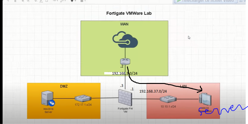

hey help me plz I want to send Syslog logs of my router to the elk server in the internal interface of my FortiGate I configured the Syslog in the router, I configure a policy rule in my FortiGate and I configured filebeat in the elk server but didn't work I don't receive the Syslog logs how can I follow the Syslog logs from my router to see the problem where?
Created on 08-16-2022 08:35 PM
Hi @Firasbg ,
Thank you for the diagram.
From what i understand , the traffic is from 192.168.3.2(router) to 192.168.37.x(server).
This policy should be From WAN > LAN.
You may verify the connectivity 1st.
Ping from router to the server. It is working
Are you able to telnet the server port?
-From router
-From same segment
If from same segment itself is not working, most probably server is blocking. Example: endpoint control, Windows firewall.
Let me know your finding 1st, then i will assist further to verify the traffic on Fortigate.
