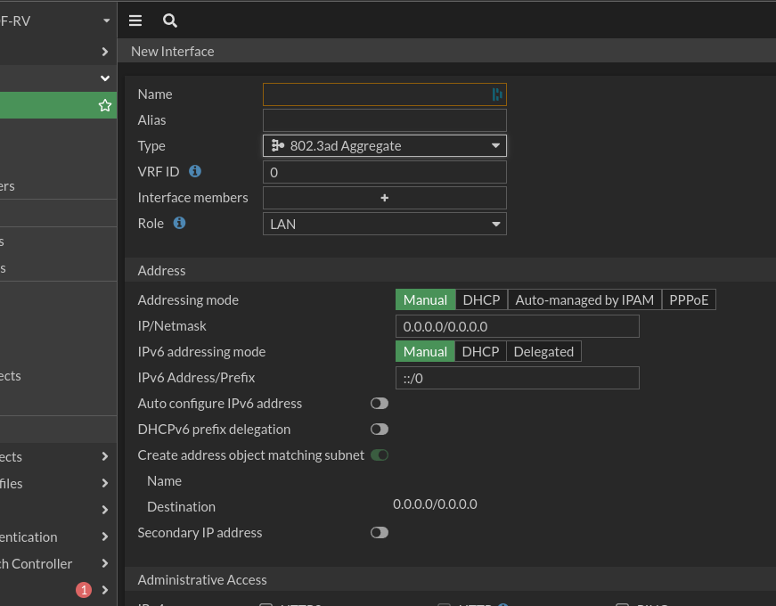

Sure, and thank you for having a look with me.
This pic is for a new 802.3ad interface and seems to require different IP netowrk info than what I have for the built-in hardware switch on the fortigate.
Are you talking about the "Create address object matching subnet"? That's only for an address object you can use it later in FW policies or some other places. If you don't plan to use it, you can just disable it. You can create an address object later if/when you need it.
Toshi
Or, LAG/LACP interface is a logical interface. You have to define an IP on it just like Cisco's "Port-channel".
You can't have hard-switch/vlan-switch interfaces as a part of LAG/LACP members. You have to remove those ports from the hard-switch/vlan-switch interfaces, like "internal" (60F), or "lan" (40F).
Toshi
