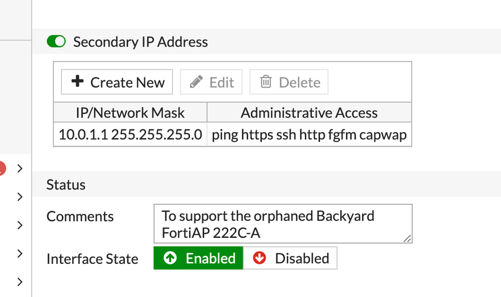

So I was wrong - this did not stop working so recently. It happened back when I was juggling the networks to satisfy a condition I never planned for - We had to move our of our house for repairs and in the temporary place there was AT&T instead of Google Fiber. They have a requirement to hold on to these 10. addresses on the public side of the modem/router. So I had to change the IPs of the devices I took with me, and consequently do the same thing for my home network (change from 10.0.1.1/24 on LAN to 192.168.1.1/24).. Apparently, everything changed except for that one FortiAP and now it’s an orphan:
But when I go to visit the web interface, I see that though I believe I have the right uername/password, I’m not allowed to log in that way. My hope then is that the Fortiwifi can still do so…
So then I need to have a valid 10.0.1.1/24 network on that lan without disrupting 192.168.1.1. This is a home network and I’m Ok with that.
I found this article: https://community.fortinet.com/t5/Support-Forum/How-to-have-multiple-subnets-in-1-lan-port/m-p/20162...
This worked, and I did need to do the changes recommended at the command line (Fortiwifi 60D v 6.0.9). In my situation I believe I can add only one from the GUI, which I do.
I end up with the following:
And under Managed FortiAPs - success!:
I next will try to see if I can get some clients to join and also to change the IP address Backyard gets so that I can have them on the same subnet. I have no need for an additional subnets on the same physical network without VLANs.
