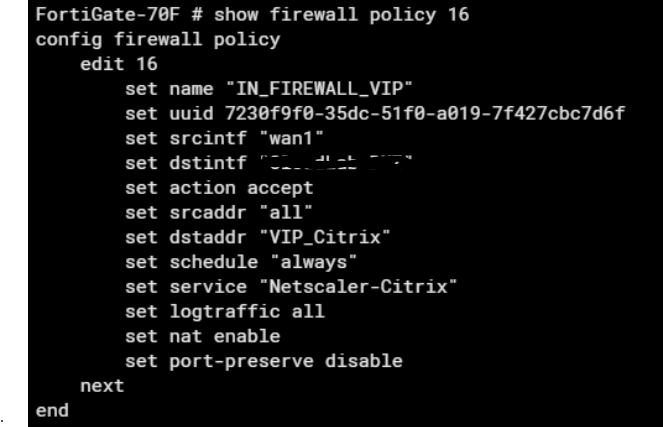

I have a home lab environment, and I have created a VIP for my Citrix Lab with NetScaler frontend. Regardless of what I try traffic to the VIP is being dropped based on debug view, but I don't see any traffic in the logs. This used to work with another service but that stopped working as well.
Fortigate-70F
Firmware: 7.6.1
Debug Trace
2025/06/12 09:31:54,"vd-root:0 received a packet(proto=6, X.X.X.X:30212->X.X.24.153:8445) tun_id=0.0.0.0 from wan1. flag [S], seq 3633665461, ack 0, win 65535"
2025/06/12 09:31:54,allocate a new session-0005eb2b
2025/06/12 09:31:54,"in-[wan1], out-[]"
2025/06/12 09:31:54,len=1
2025/06/12 09:31:54,checking gnum-100000 policy-1061
2025/06/12 09:31:54,"result: skb_flags-02000000, vid-0, ret-no-match, act-accept, flag-00000000"
2025/06/12 09:31:54,find a route: flag=80000000 gw-X.X.24.153 via root
2025/06/12 09:31:54,"in-[wan1], out-[], skb_flags-02000000, vid-0"
2025/06/12 09:31:54,"gnum-100017, check-ffffffbffc02ca54"
2025/06/12 09:31:54,"after check: ret-no-match, act-accept, flag-00000000, flag2-00000000"
2025/06/12 09:31:54,"gnum-100011, check-ffffffbffc02db70"
2025/06/12 09:31:54,"after check: ret-no-match, act-drop, flag-00000000, flag2-00000000"
2025/06/12 09:31:54,"gnum-100001, check-ffffffbffc02ca54"
2025/06/12 09:31:54,"checked gnum-100001 policy-1, ret-no-match, act-accept"
2025/06/12 09:31:54,"gnum-100001 check result: ret-no-match, act-accept, flag-00000000, flag2-00000000"
2025/06/12 09:31:54,"gnum-10000e, check-ffffffbffc02ca54"
2025/06/12 09:31:54,"checked gnum-10000e policy-4294967295, ret-no-match, act-accept"

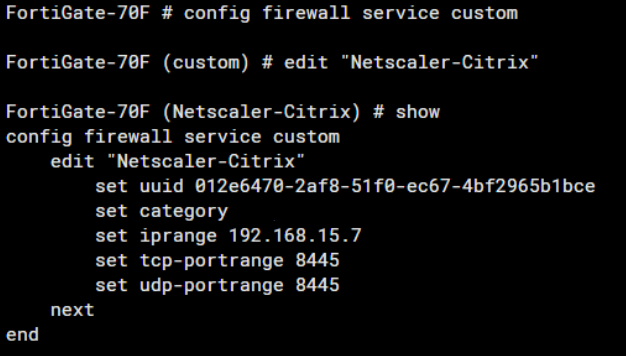

- the custom service, i would remove udp-port and iprange, leave a classic object with only tcp port 8445 that's needed and use it in the firewall rule

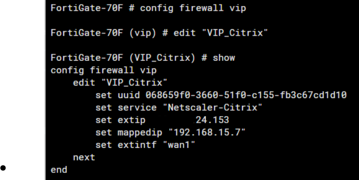

- the vip, i would remove the extintf and leave any instead
afterwards do another debug of the traffic while trying to access it.
taking off the custom service port and doing just the port number resolved it? Should I be concerned with the why?
