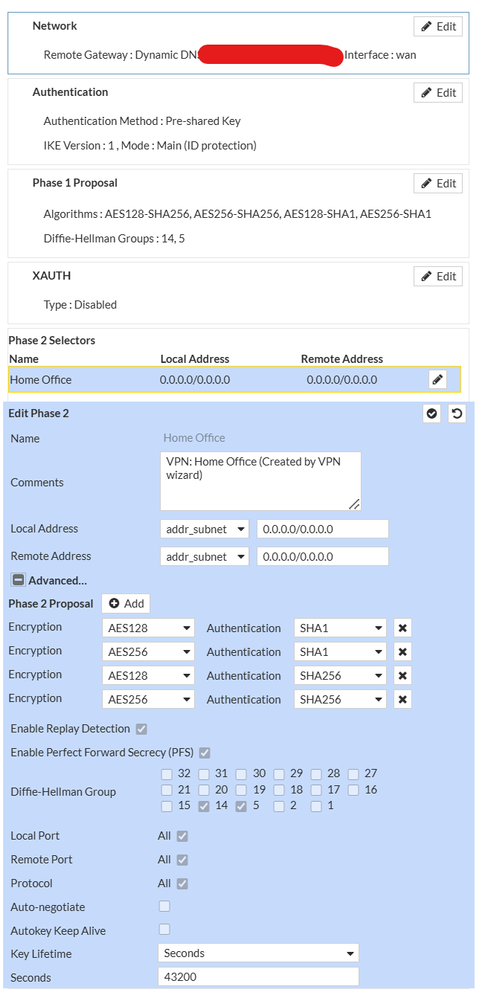

Hello rfs3pa,
It looks like it is matching phase1 proposals but it is not getting past that. Could you take a screenshot of you VPN configuration? It may be related to the xAuth and phase2 selectors being used.
Here is the screen from the Home Office Forti. Let me know if you want to see any other sections.
d
You need to share remote office config as well.
Thanks
Here is the remote office

Thanks so much for that! I had two DH groups and guess when I upgraded FW I really should have only had one.
