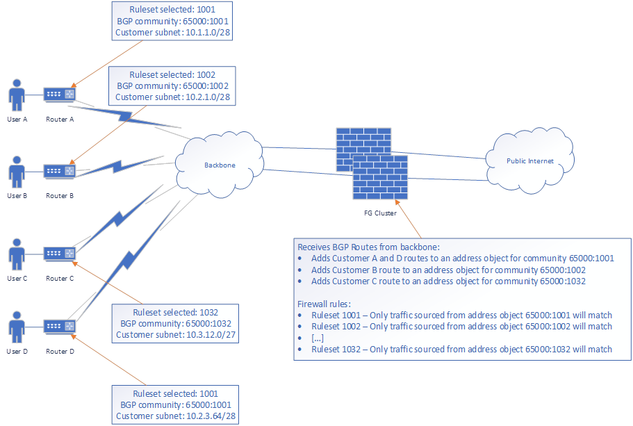

In a network that is fully leveraging BGP for any routing decisions by matching (extended) community strings, it would be nice if the community string was able to control which firewall rule gets applied to traffic as well.
Since Customer traffic is already tagged using extended communities, it would be trivial to add an additional community string in the provisioning template on the PE routers. This community string is then propagated using BGP across the backbone towards a FortiGate cluster. FortiGate reads the community string and adds the received prefix to an object (e.g.: Address objects) and traffic will be handled as determined by rules/policies setup for said object. To illustrate:
FortiOS can already assign users/addresses dynamically using the Radius SSO feature, but it cannot do this based on BGP (extended) communities at this time.
The current suggestion from Fortinet is to use an "external connector", which can analyze BGP community strings and create address lists. The connector then provides the list of addresses to the FortiGate (API/CLI).
Has anyone tried using BGP attributes to selectively assign firewall rules/policies? If yes, how did you achieve this?
Edit: If you also want this as a feature in FortiOS, give this post a thumbs-ups.

I see no reason why you wouldn't be able to use the same method to control traffic from WAN as well, either using the same community string or using an additional one. It might need a bit more thought if you are employing NAT with Virtual IP objects to provide Outside-to-Inside rules.
Rejecting, accepting or modifying routes (either the default or specific prefixes) from various locations is already possible in FortiGates - the route-map feature already allows matching on BGP attributes, such as community strings.
The benefit of being able to use community strings to dynamically create an object for use in firewall policies would be that it improves scalability of the network and make it much more dynamic, as you no longer need to define or update prefix-lists with new IP ranges (either manual or through automation). This is especially practical in global networks where the user/customer may be mobile and move from location to location.
