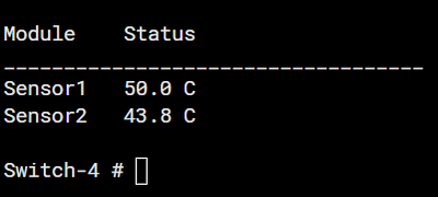

I have the following temperature from the switch

I am facing abnormal behavior issues like one of the switches stopped proving POE, and other switch was dead.
The normal temprature for a fortigate device is between 32 to 42 degree. This seems to be higher. DO you see a warning or alert is generated. Because fortiswitch generates alert once temp reaches threshold.
@rosatechnocrat no working alert but some unnormal behavior
Like issue with POE port stopped providing POE and we have to reboot the switch to fix
