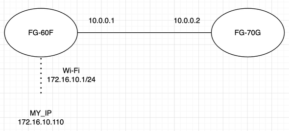

I have two Fortigates:
A Fortigate 60F and a Fortigate 70G.
On the Fortigate 60F, there is a WiFi network, where I reserved the IP address 172.16.10.110:
The Fortigate 60F is connected to the 70G via a link and a static route:
All traffic destined for the 70G must pass through the 60F.
Conversely, on the 70G:
The connection works well, everything works fine.

I want to do the same on the 70G, blocking access to https://172.16.1.1:40443/, defining “My_IP_ADDRESS” in the same way and defining "login_group" consistently and creating the two same Local-in Policy.
However, what happens is that the final deny policy blocks everyone, including me.
My PC IP is still 172.16.10.110, since I am always connected to the same network, but the Fortigate 70G, I believe, does not see me as 172.16.10.110, but as 10.0.0.1, that is the outgoing 60F interface, and I notice this by checking my access to the 70G GUI:
So, the first accept policy, reserved for 172.16.10.110, is ignored.
How can I solve this problem?
Has anyone experienced something similar?
if the source is changed into the IP of the interface, you are most likely doing NAT for the traffic on the 60F, so disable NAT for this traffic on the device for 172.16.10.110 to interface IP and port 40443 or whatever https port you are using.
