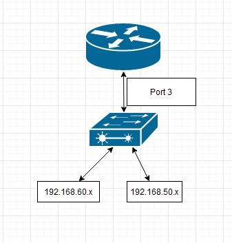

Hello. I have a FortiGate 60F and I have a layer-2 switch attached to one of the ports. On that nameless L2 switch is my WiFi WAPs (just some old Aruba's we had laying around). I want to have a guest network on those WAP's, but also want to have normal connectivity like I currently have. I'm trying to fumble my way through, but I can't seem to figure out a way to allow multiple IP/VLANs on one port. The L2 switch is on Port3, and I have that as part of the internal VLAN Switch (default setup) as pictured.
Port3 > 8-port L2 switch > two Aruba WAPs with 2 VLANs (VLAN 0 and Guest VLAN)

On the 60F, or any other FGT models, the parent interface like "internal" vlan switch/hard-switch interface, which includes port3/internal3, is non-tagged interface. On the switch it's probably equivalent to VLAN0. So 192.168.50.0/24 needs to be VLAN0 on the switch.
Then Guest VLAN n subinterface needs to be created on the internal interface, then you want to assign a GW IP in 192.168.60.0/24, like .1. Then the port3, as well as port1 and 2, carries both non-tagged/VLAN0 and VLANn traffic. You need to make the switch side port a trunk.

Thanks for the tips. I was able to connect my phone to the guest network and it got an IP address and was able to connect it to the guest VLAN (192.168.69.2 is the phones IP) but I can't get out to the internet.... I'm assuming because I don't have any firewall rules yet I think?
Mostlikely. Each VLAN interface is treated as just another interface in the policies. So if you want to connect the Guest VLAN to the internet, you need to have Guest->wan1 or 2 policy with NAT enabled.
Thanks for all your help! I got it to work! Part of it I think was that I had my Aruba WAP's configured wrong....
