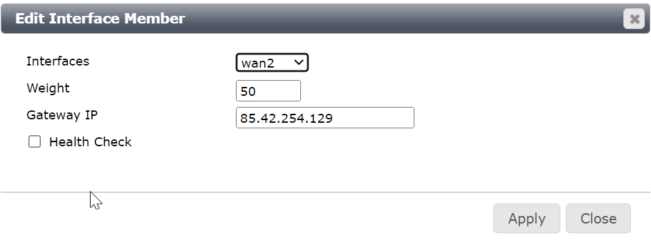

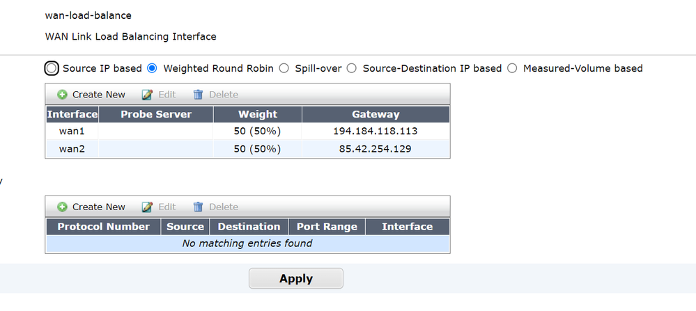

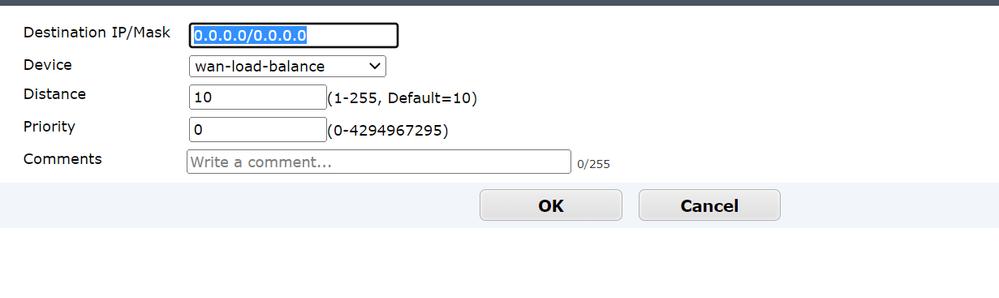

I configured a Fortigate 60D (firmware 5.2.1) with two interface Wan and i created a WAN link load balancing set "Weighted Round Robin 50/50"
The problem is pretty simple: The Interface wan2 doesn't work in any way.
I disabled interface Wan1, and i'm able with interface WAN 2 to ping the Router via Cli but i'm not able to ping 8.8.8.8
Connected with my laptop directly to the router interface with the same Fortigate's IP address i'm able to surf in internet.
I am not authorized to access the router configuration because they are owned by our ISP.
So 'm not sure where the problem is.
Below some screenshots of my configuration:
anyone can help me?

I solved the problem!
I have updated the Fortigate to the latest version and now everything works fine.
So the problem from my point of view was a bug on the OS :)

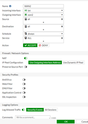

Hello, kind of late, I had the same issue, what I did is: Go to...
under IPv4Policy create a new policy
Copy the values below:
Save and hopefully, that will solve your problem.
