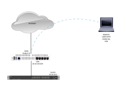

i've problem with my ssl certificate on my fortigate below design before explain you problem .

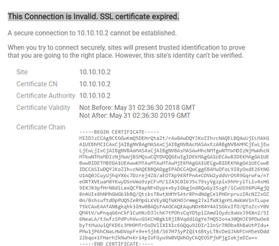

Since home, i try to connect to my switch office (cisco switch SG-250) by using ssl vpn. but it's not working i've the message bellow
i look for on internet and one way to resolve that, it to allow invalid cerfiticate. i do it and now it's working but not secure.

You're accessing the SG-250 (very old switch) via GUI(HTTPS) and its certificate has been expired long time ago. The FGT is just in the middle and checking the certificates (as you configured) coming from the server(SG-250) side and found it invalid. If you don't want to make FGT ignoring invalid certificates, your options are one of these:
1. As Alex says, get a proper certificate signed by one of common CAs and import/install it to the SG-250 [the best option among these]
2. Stop using GUI/HTTPS to manage the SG-250. CLI/SSH or HTTP would be the options.
3. Cisco might have an updated default cert. Ask their community.
