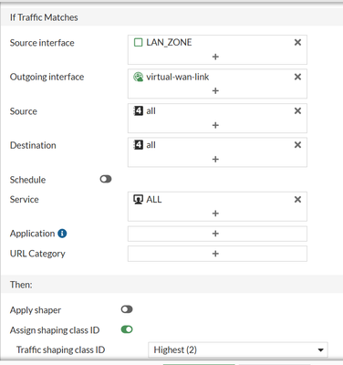

I have configured a traffic shaping profile on my FortiGate firewall, along with a traffic shaping policy where I have assigned a Class ID. However, I am unsure about the correct way to apply the traffic shaping profile to interfaces and set the outbound bandwidth.

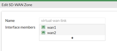

In my traffic shaping policy, I have selected the destination interface as the virtual-wan-link (WAN1 + WAN2) as the outgoing interface. My question is: if I apply the traffic shaping profile separately to WAN1 and WAN2, will the traffic shaping function as intended?
