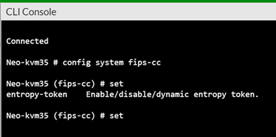

Note that even when using Certified builds, FIPS-CC mode is disabled by default after installing the firmware. Additionally, FIPS-CC mode can only be activated/configured using a serial console connection (it is not possible to enable it when connected via the Web GUI or SSH).
CLI launched through GUI (note the lack of the status option):
Compared to using a serial console connection:
