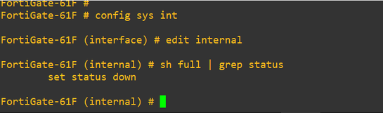

To enable FIPS, refer to Technical Tip: How to enable FIPS-CC mode.
config system interface edit internal set status up set ip <ip_address> <netmask> set allowaccess ping https end
Note: Once FIPS-CC is enabled on FortiGate, it is not possible to disable via the command set status disable.
Run the execute factoryreset command to reset the device to the factory default configuration to disable the FIPS-CC on FortiGate. |
