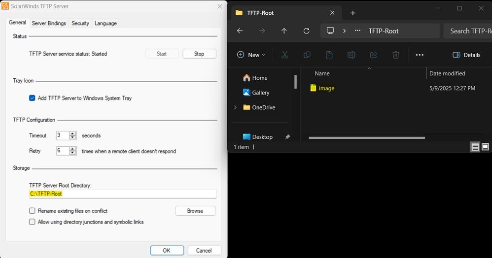

  1. Download and install the TFTP server on the computer from the SolarWinds TFTP Server
  2. Disable the Windows firewall or any other third-party packet filtering application (for example, Trend Micro LightWeight Filter Driver).

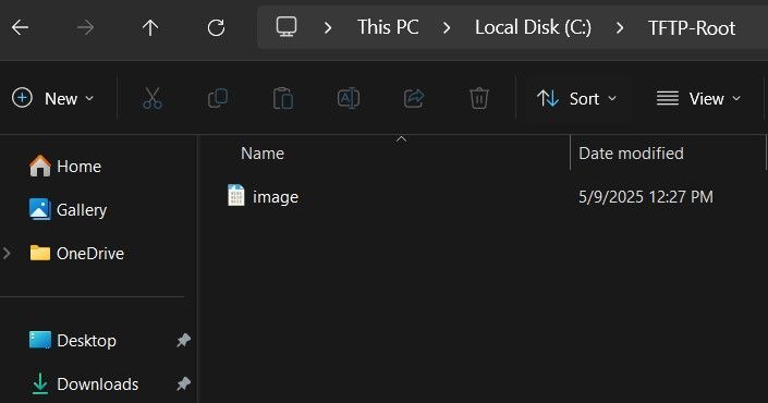

  3. Create a directory and name it something like 'TFTP'.
  4. Move the firewall image to that directory.
  5. Rename the firmware image file to 'image' while keeping the original file extension as '.out'. The reason for renaming the image to 'image.out' is to have a much shorter file name compared with the default file name when the file is downloaded from 'support.fortinet.com'. If the file name is not changed, it can cause the TFTP file transfer to fail with the below error:

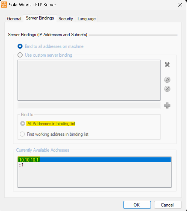

  1. Set the system's ethernet interface IP as follows (the IP can be from any subnet):
IP address: 10.10.10.1.
Subnet mask: 255.255.255.0.
Default Gateway: IP address that is set on FortiGate. In this example, 10.10.10.115.

Ensure that only the firmware file named 'image' is present in the TFTP server's 'Current Directory.' If other files are in the directory, FortiGate may fail to load the firmware, even if the filename matches 'image.out'.

                   TFTP server IP address: 10.10.10.1 <-- Host IP address running the TFTP server

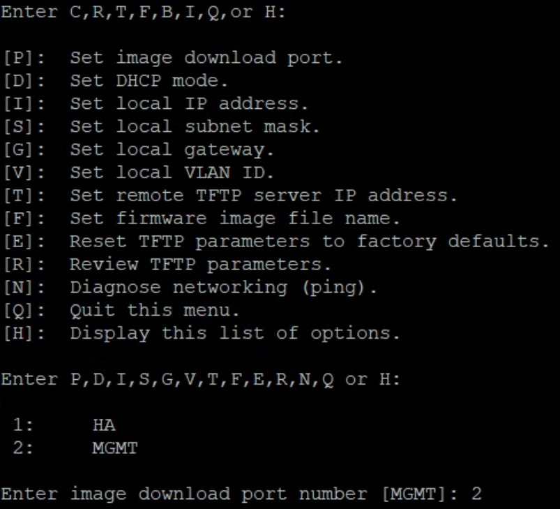

  1. Change the parameters to be in line with the TFTP server configuration.
[P]: Set firmware download port.
[D]: Set DHCP mode.
[I]: Set local IP address.
[S]: Set local subnet mask.
[G]: Set local gateway.
[V]: Set local VLAN ID.
[T]: Set remote TFTP server IP address.
[F]: Set firmware file name.
[E]: Reset TFTP parameters to factory defaults.
[R]: Review TFTP parameters.
[N]: Diagnose networking(ping).
[Q]: Quit this menu.
[H]: Display this list of options.
Enter P,D,I,S,G,V,T,F,E,R,N,Q,or H:    <-- [I]: Set local IP address.

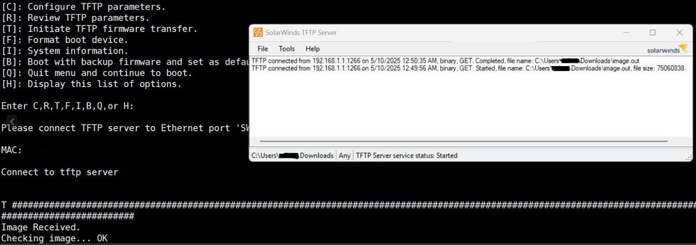

  1. Press 'T' to initiate the TFTP firmware transfer.
Please connect TFTP server to Ethernet port 'WAN1'.
MAC: 94:ff:3c:6e:e9:66
Connect to tftp server 10.10.10.1 ...
After this is connected and the transfer has begun, the screen will start filling with the '#' symbol as below. This means that the TFTP transfer has started successfully.
Image Received.
Checking image... OK
This firmware image is certified!
Save as Default firmware/Backup firmware/Run image without saving:[D/B/R]?D
