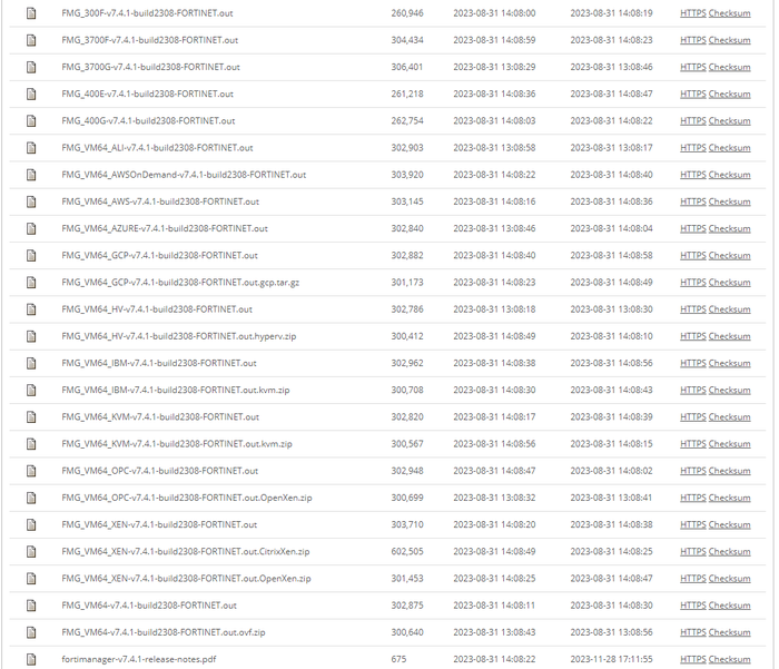

Check the upgrade path to follow for FortiManager or FortiAnalyzer. If the source image cannot be found, check the upgrade guide. For example, upgrading from v6.2.9 tov 7.4.6 may require an upgrade first to 6.2.13 as per the Firmware Upgrade Paths in the documentation, after which it will be possible to use the upgrade tool from v6.4.15 to v7.4.6.
Check the recommended FortiOS, FortiManager and FortiAnalyzer versions and if possible, based on the compatibility matrix, use the recommended one.
It is important to read the release notes and upgrade guides which are also available from the Fortinet Customer Service & Support site (Support) in the same section as the firmware image download.
Once downloaded, review the special notices, upgrade information, product integration, and support, and resolve issues, known issues, and limitations. Also, always review the compatibility matrix tool and product life cycle (software part).
Release notes can be also found in the following location:
Select the proper version using the drop-down arrow:
For other upgrade paths, see FortiManager Firmware Upgrade Paths and Supported Models.
