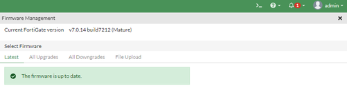

System -> Fabric Management -> Upgrade', shows ‘The firmware is up to date’ and Upgrade Status as 'Up to date' if the device is not able to retrieve Upgrade Path information from FortiGuard.
For example, a FortiGate running v7.0.14 may show its current firmware as up to date even if there is a later v7.0 release.
This will occur in the following situations:
  • The firmware does have Upgrade Path information and is up to date within its Minor Version.
  • The device has been unable to connect to FortiGuard Distribution Servers to check its image list for at least 24 hours with no configuration change. This can happen if there's an ongoing network or DNS issue.
  • The device’s FortiGuard or DNS settings have recently changed, and the device is not currently able to connect to FortiGuard.
  • The device has no valid license or was unable to retrieve its license.

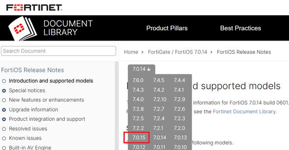

Available firmware versions in a Minor Version have Release Notes. It is also possible to subscribe to an RSS feed of Fortinet firmware releases, as shown in the article Subscribe to RSS feeds for alerts on new Fortinet firmware releases

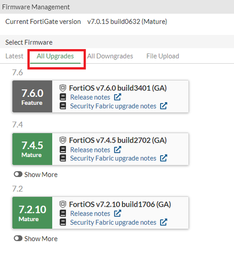

'Up to date' means up to date within the current Minor Version:
The firmware page will show the current firmware as up to date if there are no further Patch Versions in the branch, even if the End of Support date for the current Minor Version (e.g. v7.0, v7.2) has passed. If the device can retrieve upgrade path information from FortiGuard, other Minor Versions will show under the ‘All Upgrades’ page. The End of Support date for FortiOS v7.0 is 2025-09-30.
