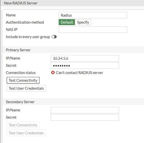

Connection with the RADIUS server is unsuccessful:

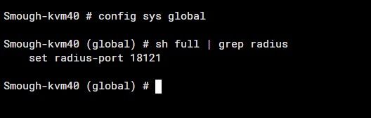

Make sure the RADIUS port is not blocked, and check if the RADIUS port is set to any other port in global settings.
If the RADIUS port is different from the default port (1812 or 1813), it should be configured as the default port 1812. In this example, the RADIUS port is 18121, which is incorrect.
If RADIUS communication is happening at a different port, that port should be configured under the RADIUS configuration as well as under global settings.
If the connection status is stuck at the connecting state with a spinning circle and there is no output from debug or sniffer, verify if the demon 'fnbamd' is spiking in CPU usage and restart the process if it is. To do so, refer to this article (The same concept applies despite the title focusing on memory): Technical Tip: How to view, verify and kill the processes consuming more memory in the GUI.
