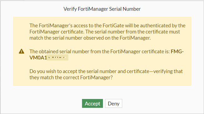

On the FortiGate: using the CLI, it is possible to edit or unset the serial number expected for the FortiManager.
Refreshing the GUI, a pop-up window should warn the administrator and ask for confirmation. Select Accept after checking the serial number on the FortiManager.
