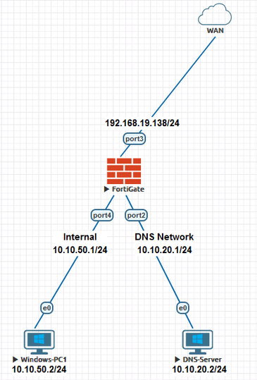

Topology Overview:
To prevent legitimate DNS traffic from being blocked by the IPv4 DoS policy while maintaining anomaly detection for other types of traffic, a dedicated DoS policy can be created to whitelist DNS traffic directed to the DNS server. Placing this policy above the general blocking policy ensures that DNS queries are exempt from threshold limits without affecting the monitoring and protection of other network traffic.

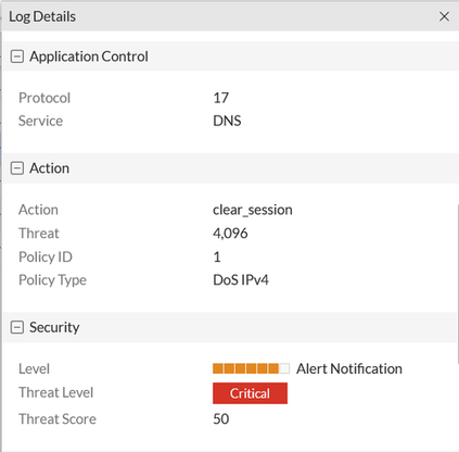

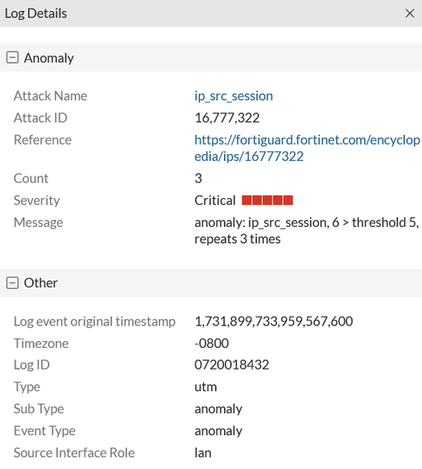

Since the policy is configured to apply to all traffic, as shown in the Anomaly Logs, legitimate DNS traffic between the internal network and the DNS server is also blocked once the threshold is reached. Adjusting the threshold or disabling the specific anomaly type would impact all network traffic across the segments, which is not ideal.

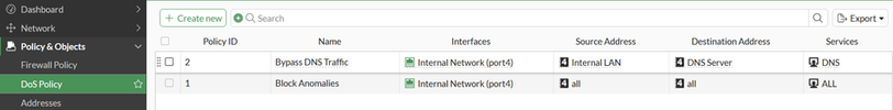

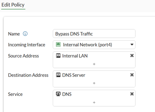

Bypass IPv4 DoS Policy in GUI:

Save and ensure this policy is placed above the general DoS policy for the interesting traffic.

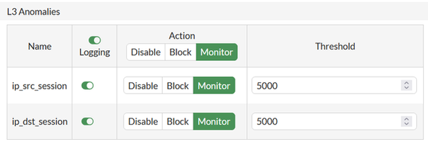

The action is set to Monitor, allowing the traffic to pass while still generating logs for visibility. This approach can be applied to whitelist specific types of traffic or bypass any type of anomaly detection.
