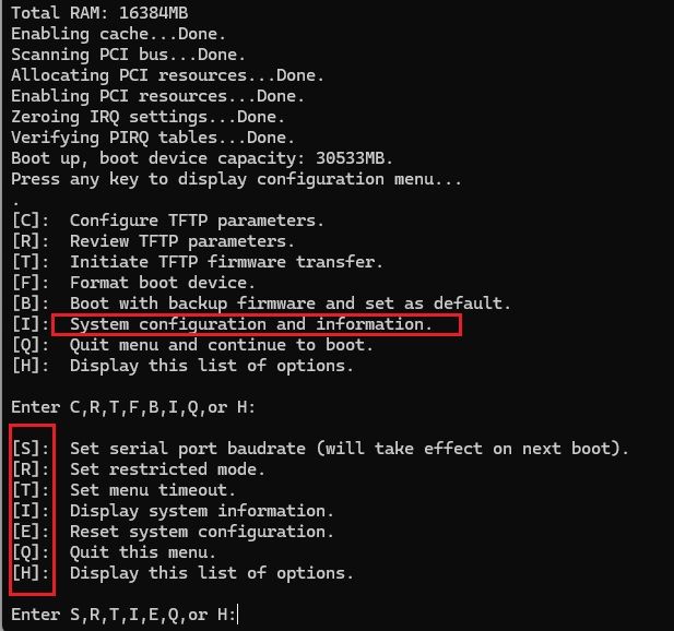

  1. To change the BIOS security level, ensure a serial console cable is connected and power on the device.
  2. When the console displays 'press any key to display configuration menu', press any key.
FortiGate-60F
Ver:05000009
Serial number: FGT60XXXXXXXXXXXXXX
CPU: 1200MHz
Total RAM: 2 GB
Initializing boot device...
Initializing MAC... NP6XLITE#0
Please wait for OS to boot, or press any key to display configuration menu.<-- Press any key.
  1. The BIOS configuration menu displays. Press 'I'.
[C]: Configure TFTP parameters.
[R]: Review TFTP parameters.
[T]: Initiate TFTP firmware transfer.
[F]: Format boot device.
[I]: System information. <-- Select this by pressing 'I'.
[B]: Boot with backup firmware and set as default.
[Q]: Quit menu and continue to boot.
[H]: Display this list of options.
Enter C,R,T,F,I,B,Q,or H:
  1. The system information menu displays. Press 'U'.
[S]: Set serial port baudrate.
[R]: Set restricted mode.
[T]: Set menu timeout.
[U]: Set security level. <- Select this by pressing 'U'.
[I]: Display system information.
[E]: Reset system configuration.
[P]: Normal POST test.
[Q]: Quit this menu.
Enter S,R,T,U,I,E,P,Q,or H:
  1. The available security levels are displayed. Enter the desired security level '0'.
[0]: Level 0 - Check image silently
[1]: Level 1 - Check image with result only
[2]: Level 2 - Check image and reinforce validity
Enter security level setting [2]: <-- Provide the digit for the intended security level [0, 1, or 2].
  1. After this, follow the menu options to quit the configuration menus and boot the device. Typically, the key sequence is 'Q', then 'Q'.
  2. The device boots with the updated security level. Earlier firmware versions may now be loaded to the device.
  3. If upgrading to later firmware versions in the future, it is recommended to set the security level back to 2 after the upgrade.
Some units, such as FortiGate 50G, 70G, 90G, 120G, and 200G, and their variants, have a 'Signed Firmware Hardware Switch' that requires physical access to change the BIOS security level (info on how to change can be found on Technical Tip: How to change BIOS security level on FortiGate G series). If BIOS security level does not appear as an option for a physical device, see the product's datasheet to verify if a device includes this feature.
