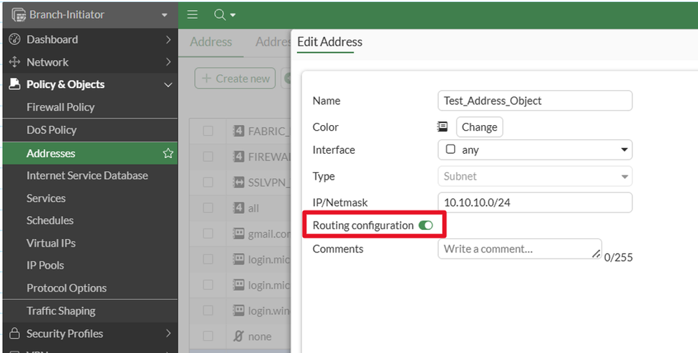

Configure an address object through the GUI under Policy & Objects, specifying the name, type, and subnet.
- In FortiOS 7.4.x and below, enable "Static route configuration" option while creating an address object and address group.
- Beginning FortiOS 7.6.x, enable "Routing configuration" option while creating an address object and address group.
GUI view:
CLI view:
config firewall address
edit "Test_Address_Object"
set uuid bc6f2364-f3b1-51f0-d076-f55395a71975
set allow-routing enable       << Important to enable this configuration
set subnet 10.10.10.0 255.255.255.0

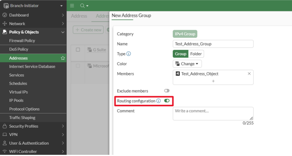

Configure an address group in the GUI under Policy & Objects, specifying the name and the members:
GUI view:
CLI view:
config firewall addrgrp
edit "Test_Address_Group"
set member "Test_Address_Object"
set uuid 0fb59cd2-f3b3-51f0-ad39-1d2c3a984efa

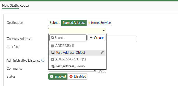

Now, address object or address group is available for selection while configuring static route.
GUI view:
CLI view:
lab # config router static
lab (static) # edit 10
new entry '10' added
lab (10) # set dstaddr
<string> please input string value
Test_Address_Object address        <<<< Available address object
Test_Address_Group addrgrp         <<<< Available address group
