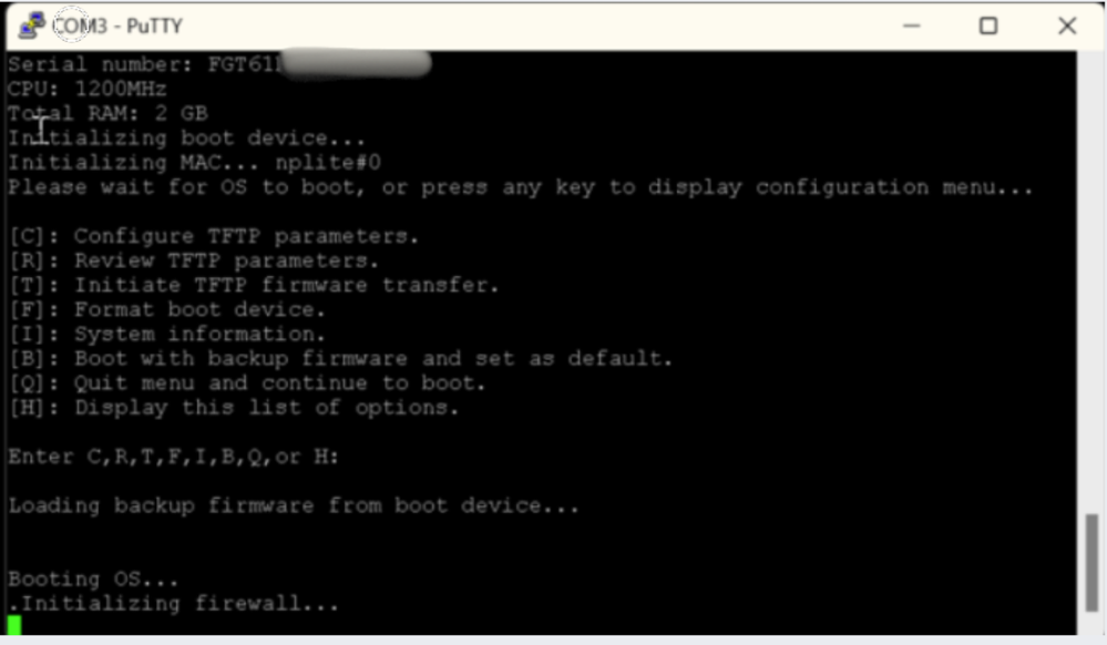

Alternate Method:
Selecting an alternate firmware from the boot menu:
Once this is done, FortiGate will boot up with the backup firmware image.
