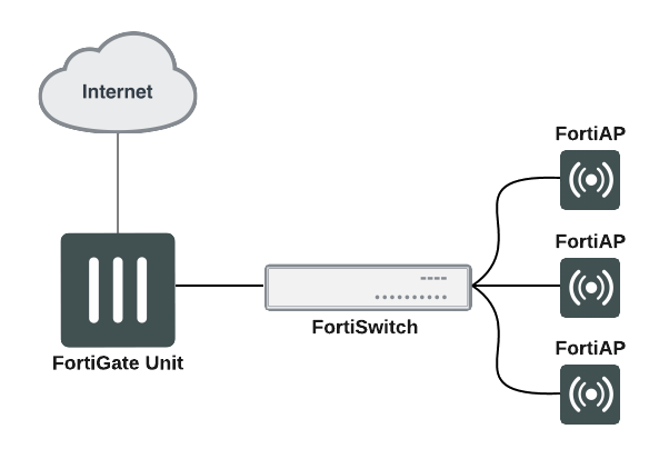

For demonstration, the following example was set up with detection applied on a secure LAN edge architecture:
  1. FortiAP SSID as a connected interface. Enable device detection in virtual SSID interface under 'WiFi & Switch Controller -> SSID'
  1. Firewall Policy with an application control sensor to the internet-facing policy.
Traffic must be initiated from the IoT device for the detection to work.
