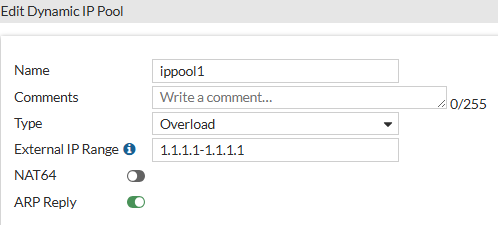

In this explicit proxy configuration example, an IP pool with a single IP address is configured with set arp-reply enable configured by default, along with a blackhole route that matches the reply traffic destined to the IP pool.
config firewall ippool
    edit “ippool1”
        set startip 1.1.1.1
        set endip 1.1.1.1

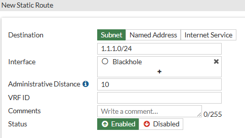

config router static
        set dst 1.1.1.0 255.255.255.0
        set blackhole enable

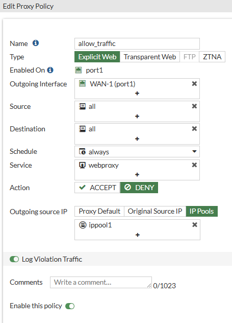

Suppose the explicit web proxy on the FortiGate has already been enabled and configured using the steps described in the Explicit web proxy.
In the corresponding proxy policy, configure the IP pool ippool1 as the source IP address.
config firewall proxy-policy
        set name "allow_traffic"
        set proxy explicit-web
        set dstintf "port1"
        set srcaddr "all"
        set poolname "ippool1"
        set dstaddr "all"
        set service "webproxy"
Because the blackhole route matches the reply traffic to the IP pool and drops it, the reply traffic cannot reach the explicit web proxy on the FortiGate.
To resolve the issue caused by the blackhole route configuration,  consider configuring one of the following settings:
  • Delete the blackhole route and ensure another route is defined that matches traffic for the IP pool reply traffic.
In the example below, a default route for the outgoing interface port1 is defined, which matches the IP pool reply traffic.
    delete 1
        set dst 0.0.0.0 0.0.0.0
        set device port1
  • Keep the blackhole route, and if the IP pool consists of a single IP address, as in this example, configure this IP address as a secondary IP address on an outgoing FortiGate interface.
In the example below, the outgoing interface port1 has a secondary IP of 1.1.1.1/24 defined on it.
