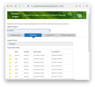

Step 12 - Open the Support link and select Firmware Download.
Step 13 - Go to Downloads and select the product (FortiGate), then select the latest Firmware Image folder:
Step 14 - Navigate to the desired Mature or Feature Release.
Step 15 - Download the Firmware, Release Notes and SNMP MIB files for the desired version and device type.
