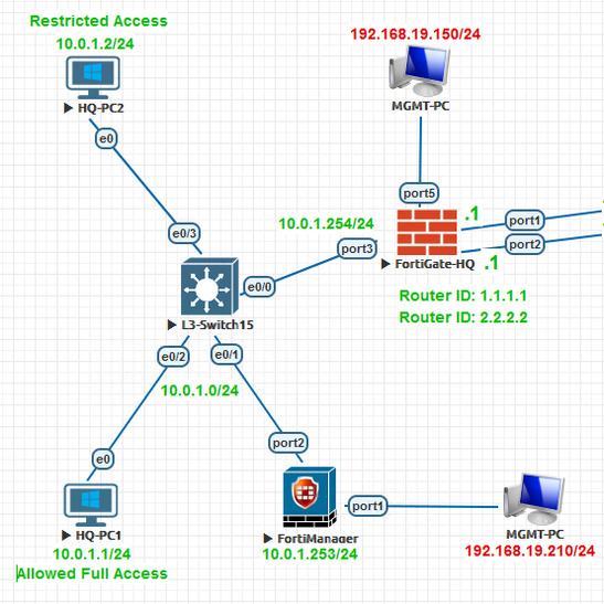

Topology:

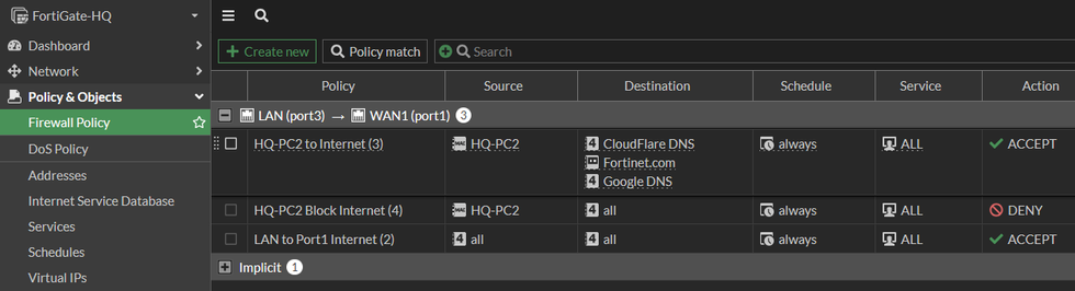

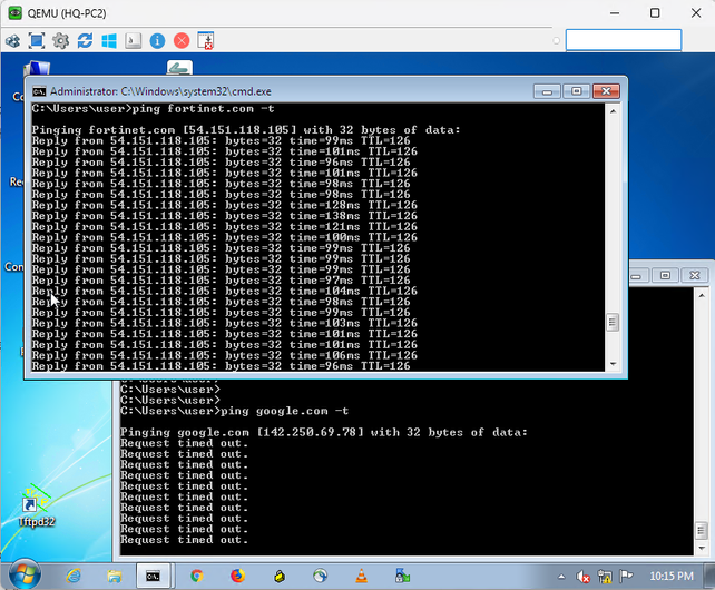

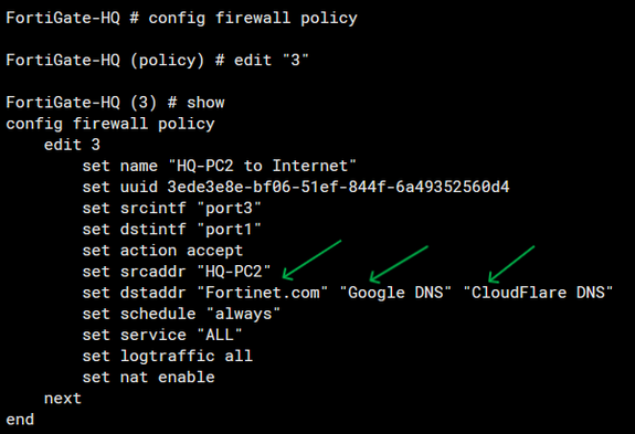

Policy to Allow traffic to a specific website fortinet.com' in addition to the desired DNS servers.

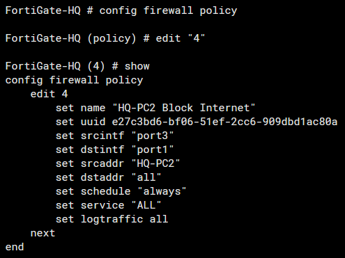

Policy to Block the device or devices in question from accessing all websites.
A general policy to allow unrestricted access to all websites for all other devices.
