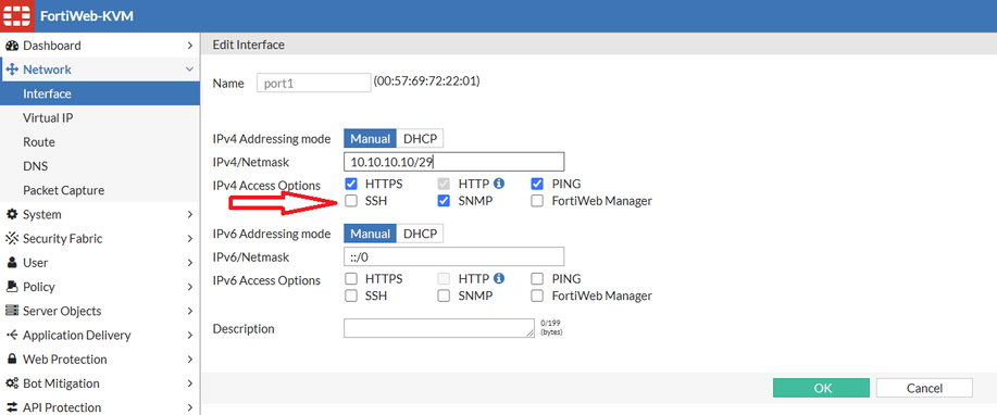

  1. Disable SSH and use CLI console from GUI.
In GUI:
In CLI:
config system interface
    edit "port1"
        set type physical
        set ip X.X.X.X/X
        set allowaccess ping ssh snmp http https
                config secondaryip
                config classless_static_route
Run the CLI command stated below to disable SSH administrative access.
    edit "port1"
         set allowaccess ping snmp http https
It will exclude ‘SSH’ in allow-access settings.
Repeat the same steps in SSH-enabled interfaces.
