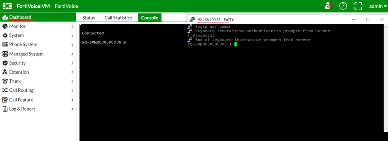

1) Open a CLI by console GUI or by SSH:

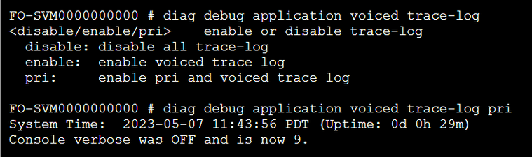

2) Activate trace log for PRI trunk.
diag debug application voiced trace-log pri
3) Make test calls using PRI trunk and once done run the below command to disable the trace.
diag debug application voiced trace-log disable
