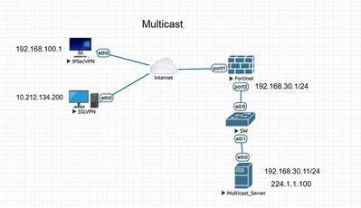

Topology:

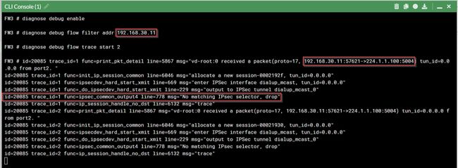

Debugging the flow, the following information can be found: 'No matching IPsec selector, drop'

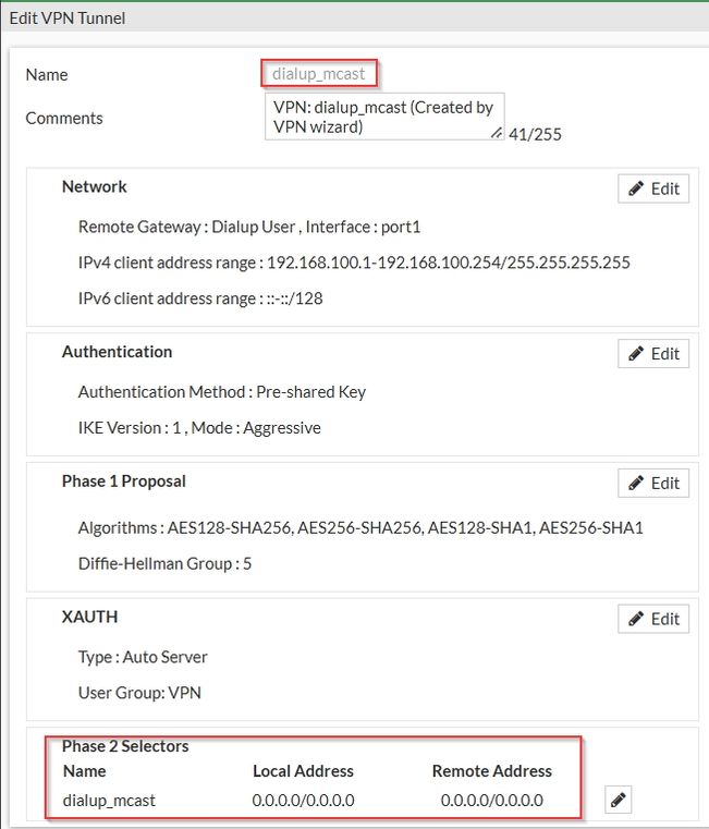

The curious point of this log is that all sources and destinations are allowed in the phase 2 selectors.

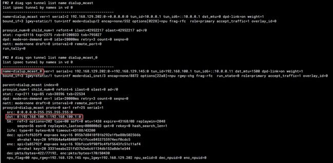

When using a dial-up VPN with FortiClient, FortiClient will always use its IP address as the destination address in the phase 2 selector. Therefore, the return traffic from its IP to the multicast address via the dial-up VPN will be dropped because the destination address in the phase 2 selectors does not match:
